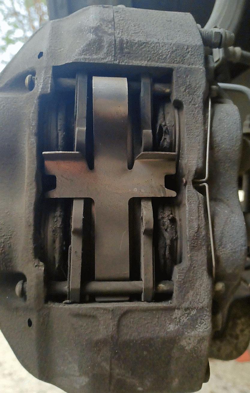

I need to replace the four boots in the front brake calipers because they're torn (and I need to pass an inspection that I already failed due in part to that).

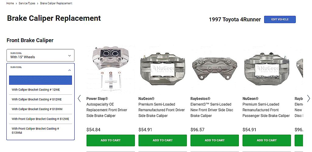

On CARID the 15 inch wheel selection asks me which of five different calipers I have.
1. With Caliper Bracket Casting # 12WE
2. With Caliper Bracket Casting # S12WE
3. With Caliper Bracket Casting # S13WM
4. With Front Caliper Bracket Casting # S12WE
5. With Front Caliper Bracket Casting # S13WM
Not knowing how to tell, I called CARID customer support at 800.505.3274 and they said the choice matters (because the parts are different) but that I'd have to ask Toyota since they couldn't find it in a VIN lookup table.
I called the local Toyota parts department who didn't even know what I was asking them.
Do you know how I can tell what which caliper bracket it is that I have?

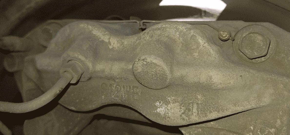

The calipers will be stamped on the back side of the caliper (the side facing the vehicle frame). There's a couple pictures in this post that show the stampings: https://www.toyota-4runner.org/835440-post2.html
By the way, 1/2/4 are the same and 3/5 are the same.
Thank you for that answer as those pictures in that thread were perfect.
Luckily I didn't have to lift the 4Runner to see the S12WE stamped on the inside of the caliper (facing the frame).

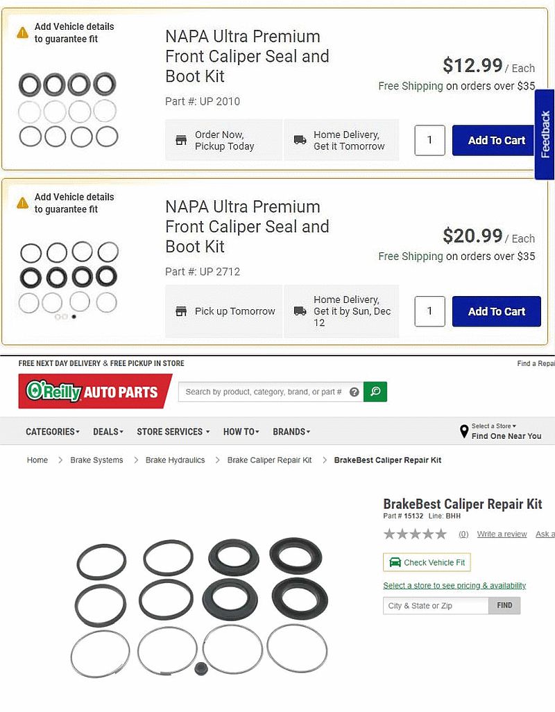

I called O'Reilly and Napa and Autozone.
Napa has a $13/caliper 12-part rebuild kit (P/N UP 2010).
O'Reilly also has a $13/caliper 13-part rebuild kit (P/N 15132)
Anyone have experience with these caliper rebuild kits?
