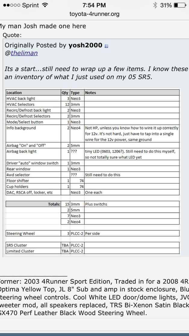

not really sure about OEM lights and how the part numbers work, but it should be a 3mm T-1 twistlock bulb
i realize you aren't looking for something brighter or colored but if you were to switch to LED the p/n that would fit would be a Neo3. when i was looking for bulbs for my LED swap i found that most of the Neo3's were discontinued, replaced with the Neo3-xHP which is a brighter variant. technically you could dim it with the cluster dimmer control
https://www.superbrightleds.com/moreinfo/instrument-cluster-gauge/neox-led-bulb-high-power-instrument-panel-led/221/1006/
^ link to the site i used
attached is a pic i stole from one of the giant LED swap threads on here that i used for reference
just my .02 hope that helps a bit :shrug:
