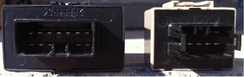

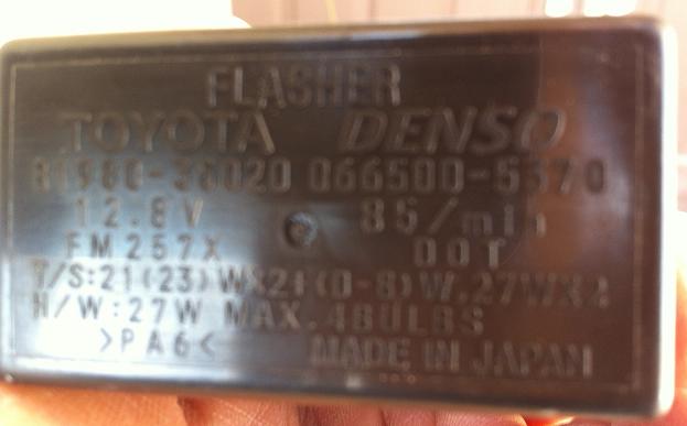

What is the LED flasher relay Part# replacement for the OEM flasher relay on DRL equipped 2005 4Runners?
The OEM part # is 81980-35020 066500-5570. See pic below - as you can see it's a 12 pin relay - its the one on the left in the second pic.
Basically I need to find the equivalent LED relay so that I can swap out my incandescent turn signal indicators for LEDs.
I used to own a 2011 tacoma....there was a thread over there on TW about using a GM/Cadillac flasher. Not sure the end result of that one...may want to search.
Has anyone tried to mod the 12 pin relay so you can use LED's without the hyper flash. I know on my prelude I just removed one of the resistors in the relay. Has anyone tried to do this with the 12 pin DRL relay?
Found this. I'm going to give it a go. :D
LED DRL bulb replacement with stock DRL flasher and NO RESISTORS! - Tacoma World Forums
i just read the thread. they just grind the metal ring/hoop down?
why not just cut it off? or are they just grinding the metal down to a thinner hoop ?
i had gone through the frustration of not having a led blink when the other side blinks fine...
the hoop is a resistor. If you cut it off the relay wont work at all. When you grind the hoop you are increasing the resistance just like if you pinch a hose. It tricks the flasher into thinking you are running an incandescent.
