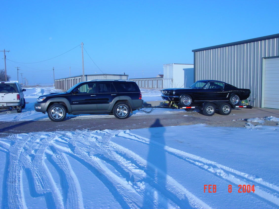

Like Titanpat57 said its about proper weight distribution. Most of the utility type trailers with the wood decks and stuff are for hauling tractors. They have the axils towards the rear for the heavy back ends of tractors. hauling a car on these with the engine forward, too much tongue weigh. Back the car on these type. Most car haulers will have the axils further up closer to center. So it depends on the trailer. Bent axils from overloading can cause the trailer to wander side to side or not track straight. A little toe in helps the trailer track straight. What I like to do is measure ride heights at the fenders front and back unloaded. Then load the car measure again and right it down. See how it pulls. When its good you can repeat it every time. I find with my trailer about two inches of squat in the rear is perfect.
