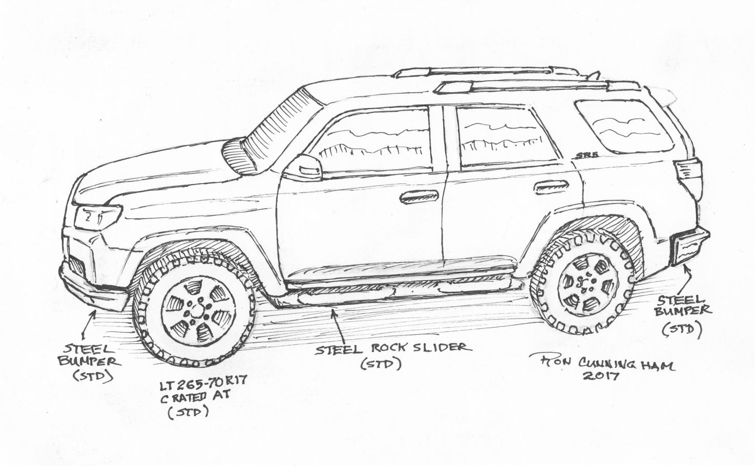

If I were a Toyota Engineer and I were going to do a face lift version; or even to be considering a sixth gen, I would make mostly functional changes:
First of all I'd pretty much keep the body, frame and running gear we've all come to like on the 2013 SR5. It's almost perfect as is; changes I would make:
1. Add steel bumpers at both ends - less deep and none of the air dams plastic underneath so that we could gain perhaps 4 or five degrees of approach and departure angles.
2. A standard, integrated steel rock slider set at about 12 inches of ground clearance - while at it keep the minimum ground clearance of the frame and skid plates at about 11 inches.
3. All cosmetic, entertainment stuff about the same as '13 SR5 (Air conditioning, power windows, power remote door locks, power brakes and steering, part time 4wd, A-Trac, AM/FM radio) except I'd delete a few things: get rid of the remote buttons on the steering wheel, NO entune, blue tooth, voice actuated crap. Keep it simple.
4. Standard Lt-265-17 C rated AT tires - optional E rated AT or Mt tires.
5. Interior would come with the basic cloth seats and carpets.
"Limited packages' would be available in several categories where you could individually order such things as leather seats, third row seats, upgraded AC, full time 4wd, and all the various entertainment stuff. The totally urban users could even delete the LT- AT tires.
"Rock Packages" would also be available where functional things such as lockers, KDSS, etc. could individually be ordered.

Likely wont pass crash standards with a metal bumper. Also plenty of mall crawlers need max traction tires... jumping the shopping cart pen is about the same as doing the rubicon....:zoom:
The truck needs a decent option like ARB beer fridge and custom pop out lawn chairs for drinking..or maybe a mattress in the back that is inflatable for easy storage...make this humpin truck full on pimpin for pulling over anywhere and do it with the ladies...:rofl:
You would never get this past the corporation. They would NEVER offer this many options. You normally get 3-4 trim levels and that is it. You can get some "Packages" but you almost never get to choose each individual thing. They may make an Off Road Version, but it is going to come with the entire package.

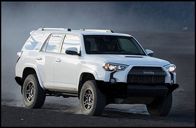

Yes to body and frame. But not the 2013. I frankly like my 2017's appearance. That said....
1) Agree with the bumpers. I would extend it all the way across the bottom of the front (see: my ghetto MS Paint quickie drawing). I'd consider aluminum instead of steel. Bumpers tend to be a heavy part, so aluminum on these would be a benefit. Body panels... aluminum can be a PITA for these. I'm not a fan of mixing metals, but for bumpers... probably the easiest place to do it.
2) With the clearance, part of the issue (at least on the 2017) is the nose comes out pretty damn far. They could probably shorten the front end about 4-6" and improve the approach angle. The rear, I'd have the angle on the rear. bumper come up a little more aggressively. then again, I'm not as worried about hiding the spare as someone at Toyota might be.
3) I'd agree with the rock slider and would add additional skid plates as part of a TRD Off Road Package. For SR5's, no.
4) Agree with buttons on wheel. Just too many. It's overkill. Simplify it. Directional pad with push button middle.
5) The current Limited style/set-up I'd MAYBE retain for our fancy-pants crowd. See next....
6) I'd seriously consider ditching the RWD only models. Simplify production. make all 4WD. If you want a 2WD SUV, go get a Highlander or Sequoia. Make the 4Runner your true SPORT utility vehicle. Make the SR5 the base. TRD Off Road the "Rubicon" model (feel dirty even saying that). Put LT Tires, sliders, skids, with a slightly upfitted suspension on it. Make your TRD PRO your top-line special edition.
7) Seriously consider a diesel powerplant. Sure, you might get a break with the whole mess with the EPA and current administration right now. If you're not looking ahead though, you're going to get your butt whipped in the long run. Or, if you really don't want to do diesel, take that 3.5L Tacoma engine and turbocharge it. Lord knows there's enough space in the front end right now for an intercooler.

Fair. But the weight savings on that would be ... iffy?
The bumpers, consider the Pelfrybuilt. 62lbs (not counting the paint/coating).
2014-2017 4Runner Aluminum Front Plate Bumper | Pelfreybilt
.... versus the steel version clocking in at 130lbs.
2014-2017 4Runner Steel Front Plate Bumper (PRO) | Off Road Bumper | Pelfreybilt
That's one of the heavier things you can swap.
