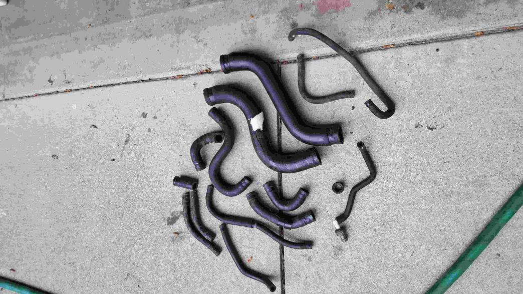

I recently replaced all the coolant hoses. For a 19+ year old car it's probably a good idea to do it. They will most likely spring a leak at the worst time possible in the most horrid location. The ones that fought with me the most were the oil cooler hoses. The heater core and rear heater were a piece of cake. I highly recommend getting a set of long needle nose pliers. To do all the hoses OEM toyota, was somewhere around $205 for all oem hoses. Since oem lasted 19+ years I went with oem.

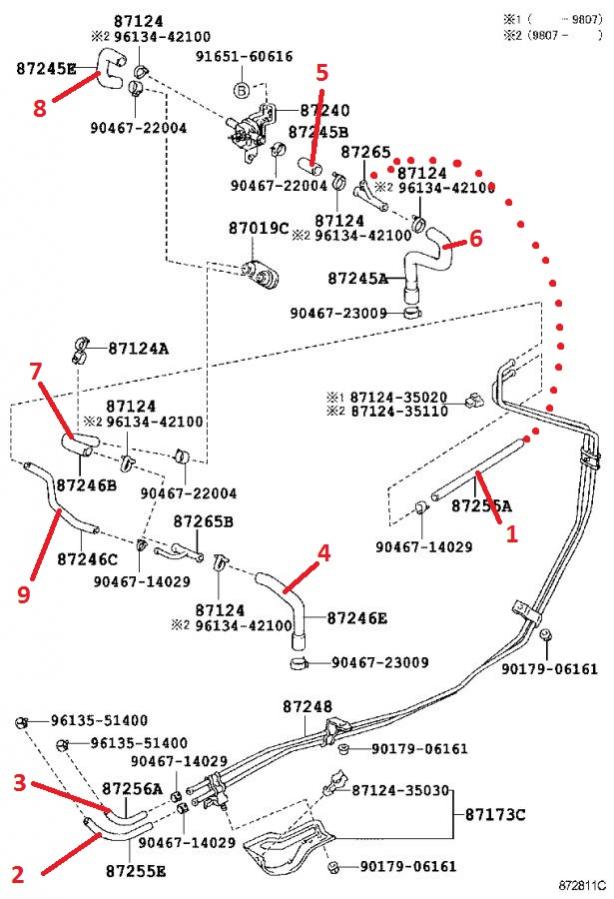

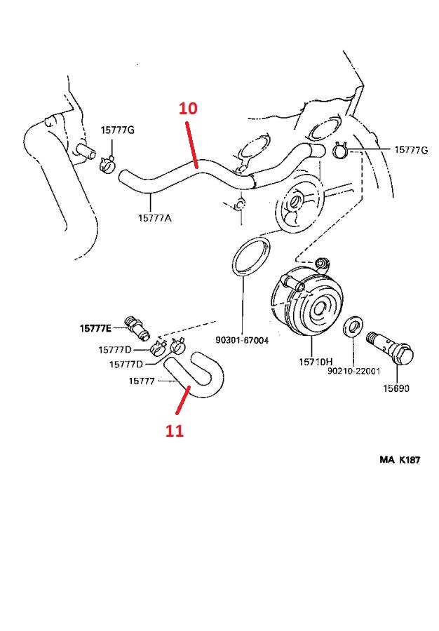

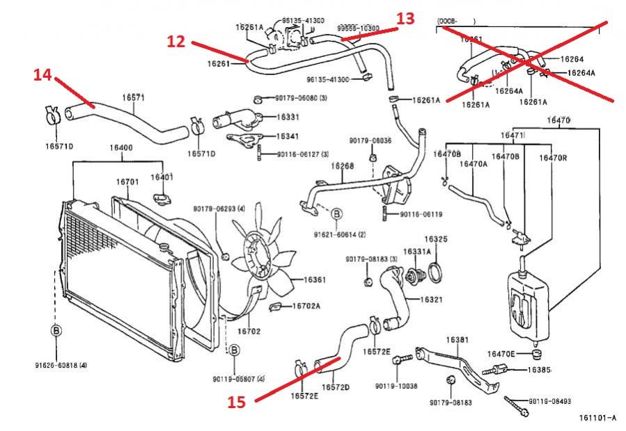

Okay, there are a few vin splits, so this is your responsibility to double check to make sure they fit your 4runner.
Since my vin is above 200008 I used 200008 and up part #'s.
Once again double check your vin split with hose part numbers, they have up to 4 different hoses, it's not my responsibility if you order the wrong part #'s.
My 4runner is a 2000 4wd SR5 V-6 w/rear heater.
Perfectly fine to run 100% water UNLESS YOU ARE IN FREEZING WEATHER!!!!!!!!!!! Antifreeze is exactly that, prevents the coolant from freezing (along with some rust preventative), does ZERO to help cool the engine, its actually bad to run to high of a concentrate of coolant vs water. I ran 100% distilled water and rad flush for 3 weeks in my 4runner. I also only run distilled water in my miata with water wetter. My 4runner is running 50/50 and water wetter as it will see winter weather.
Look at corresponding pics to match up the hose locations.
1. 87245-35770
2. 87245-35451
3. 87245-35461
4. 87245-35700
5. 87245-35690
6. 87245-35680
7. 87245-35710
8. 87245-35670
9. 87245-3D090
10. 15778-62030
11. 15777-62020
12. 16261-62060
13. 99556-10300
14. 16571-62070
15. 16572-62090
