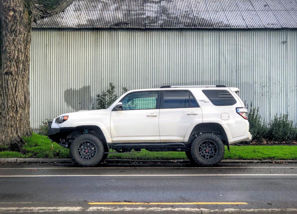

I have 265/70/17 KO2’s and maybe a 2.5-3” lift and just felt they looked small. Was thinking 285/70 might still look a little small haha. But it’s my DD so 285/70 prob makes sense. Small accentuates the “lifted” look too haha

Nice looking rig btw. I couldn't find the "Like" button or I would have done that
