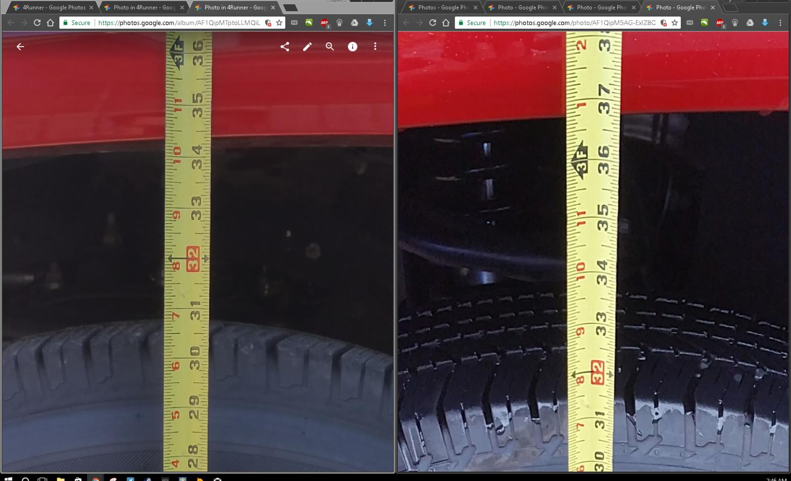

Took these measurements before I installed my 6112's earlier this year.

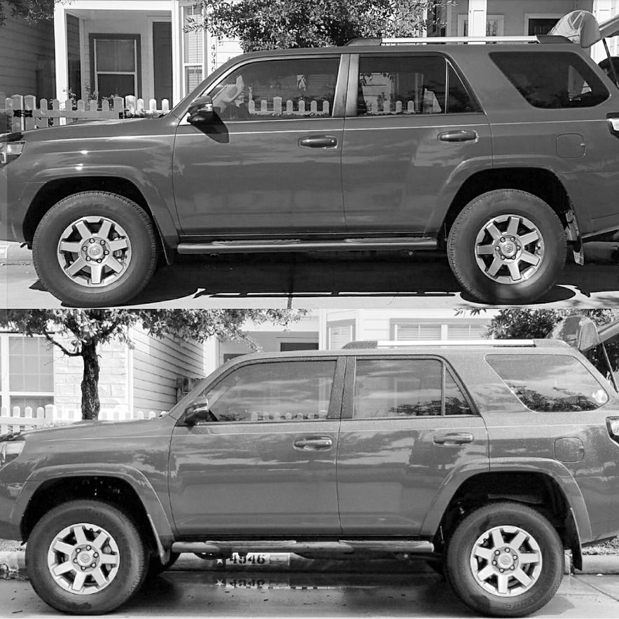

Revised version using clip 7 on driver side and 6 on the passenger side.

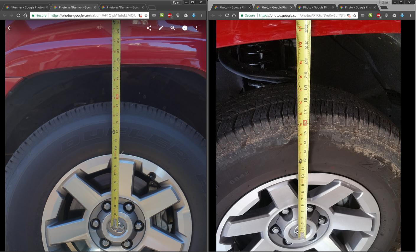

Not the best angle for the afters but it sits just around 22.5 from the hub to the fender and 36.75" from ground to fender. Hope it helps. These are just the driver's side. The passenger side (not pictured) actually still sits a quarter higher to this day. Doesn't bother me. Maybe a 7/5 clip setting could fix that. Everyone's mileage may vary though. I just went by the instructions though.
I actually took measurements this past weekend but I can't remember the numbers off the top of my head. But the passenger side is indeed a tad higher since install in February.
hub to fender
ground to fender
