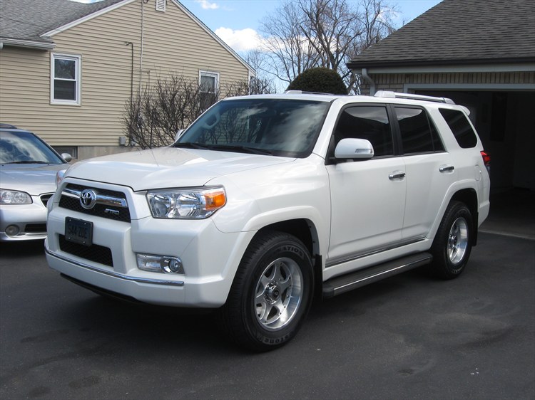

Just put my summer tires back on. Running a 275/65/18 tire with 35 psi. Seems just right.
