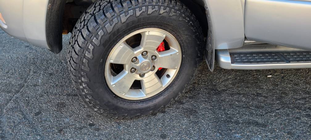

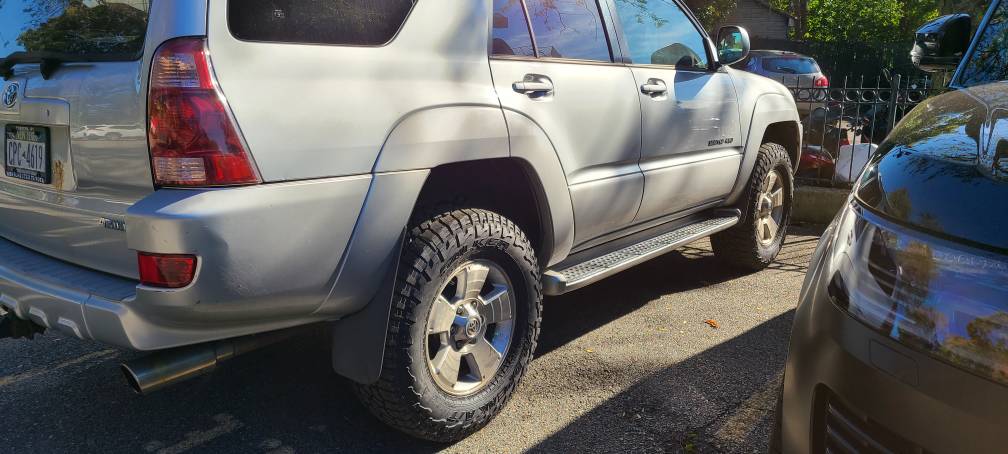

Just got this falken wildpeak 265/70/17 installed today. I have fj moog and bilstein 5100 . Front set one setting higher to lever the truck . No rubbing 20211106_111026.jpg20211106_104059.jpg
Sent from my SM-G986U using Tapatalk
