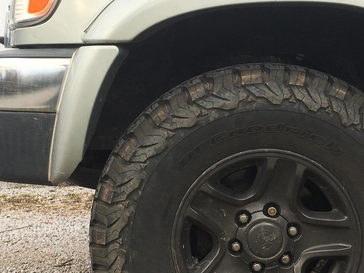

So I recently purchased a 2001 4 runner, and it has 33” tires with a 3” lift, the tires are pretty close to the front bumper.
What is a good way to get more clearance without spending $100’s of dollars.

The lower portion is plastic and really easy to trim with a Dremel, die grinder, or even a serrated knife.
You shouldn't rub the bumper unless you have wide flares. At full lock I would rub the wide flare portion on the bumper. I just removed those, and the problem was solved.
I will definitely just trim the plastic!
If you start noticing it's rubbing on the other side next, others have had luck hammering down the pinch welds just a bit to get enough clearance. If you search "tire rubbing" in the forums there's a lot of helpful threads.

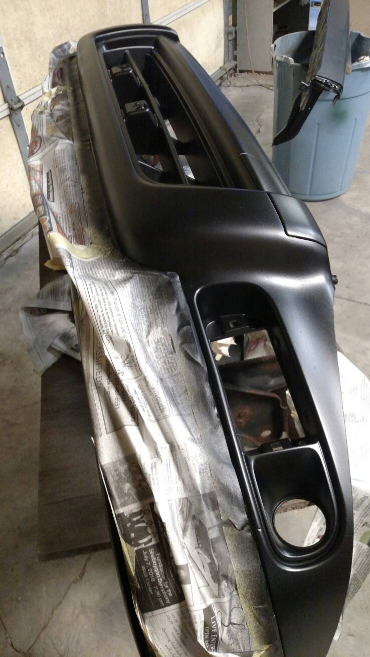

Definitely trim the plastic valence with a dremel or cutoff wheel! And like everyone else is saying, hammer back the pinch weld on the rearward side. Here is a pic of how I trimmed the valence, feel free to check out my build thread for more pics.
Hope this helps!

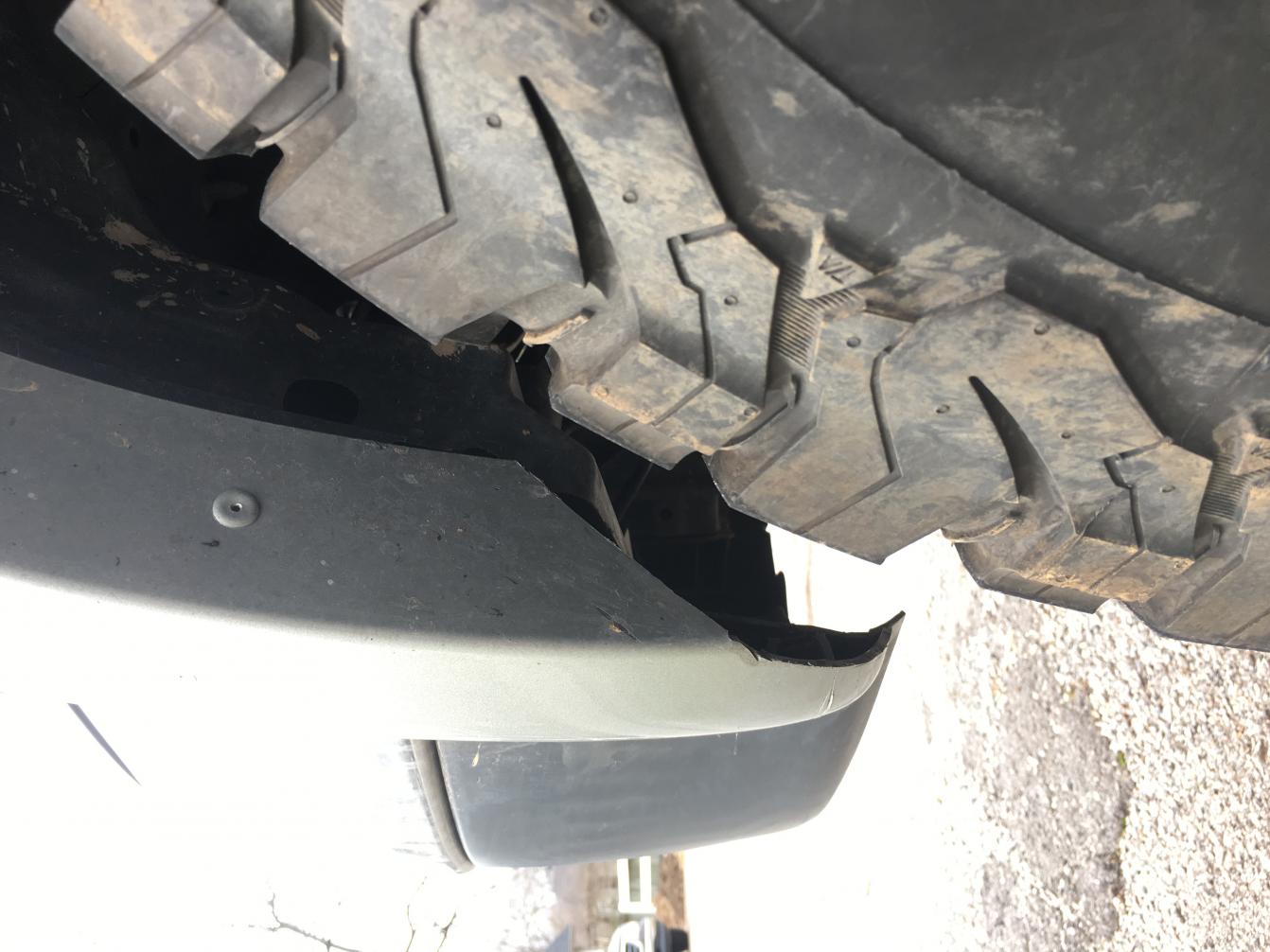

Here's some giant sideways pics of how I cut mine. Doesn't rub with 33s and about 2.25" lift.
