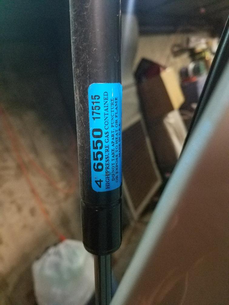

Yup. They open slower, and need a little more force to close, but no way am I spending OEM money. Just be sure you have something to hold the hatch up while you do it..

Once you pop the latch do those Strongarm 6550 struts lift the hatch on their own or do you need to give the hatch a boost up ?
