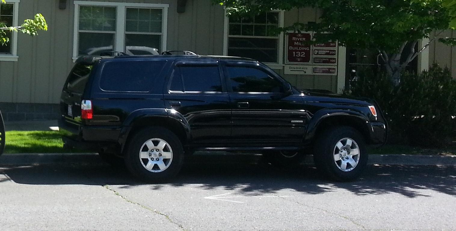

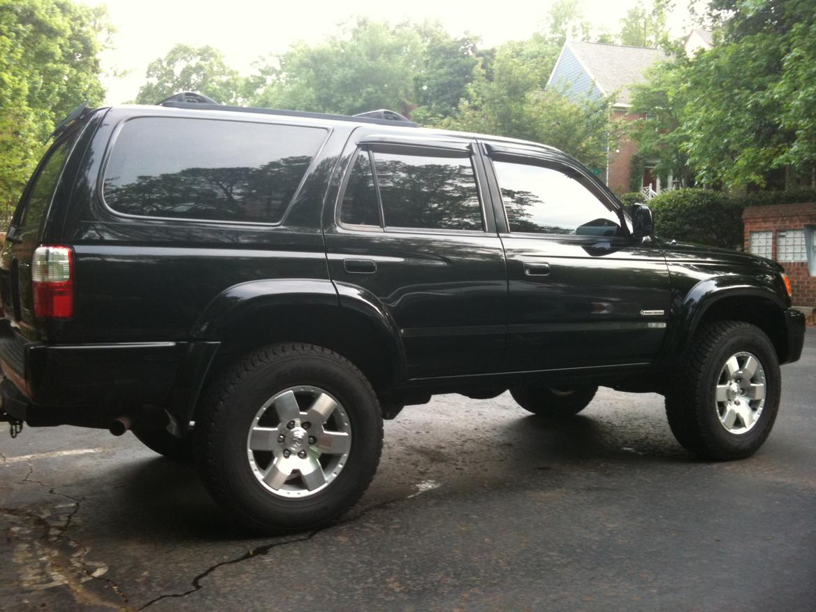

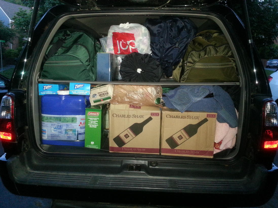

A few months ago I hauled approx 800# in the back for 7770 miles cross country. I had crap packed into every crevasse, it was just as packed from side to side top to bottom and all the way to the front seats.
I have a 3" lift with OME 883/891, I was down in the back probably an inch or more and it actually rode pretty well.
The 2nd picture shows it from a side view when loaded.
Bottom picture is unloaded
All in all it handled this load really well and I even got very good MPG on the trip.
