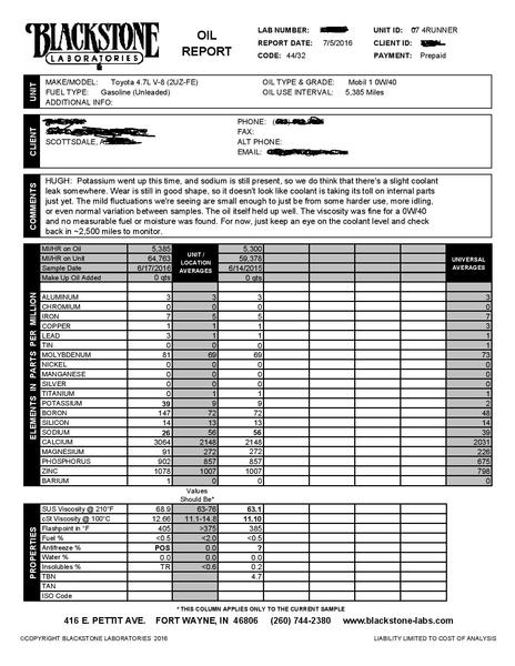

I mentioned in an earlier post that I use Mobil 1 0w40 and here is a report of using it (for the most part - previous OC, 6/14 to 6/15, had about 1.5 quarts of M1 5w30 High Mileage).
Barring what seems to be possibly a TINY seep of coolant, its a good report and nothing to worry about. I could run it longer, but at the moment I only drive about 5k a year so that is how long I go.
0w40 is supposedly Mobil's best oil and using it shows no harm whatsoever.

The brilliant people are Google for allowing facts and information to be found and Blackstone Labs for having the scientific ability to produce a detailed picture of how an engine is running. Give it a whirl.
