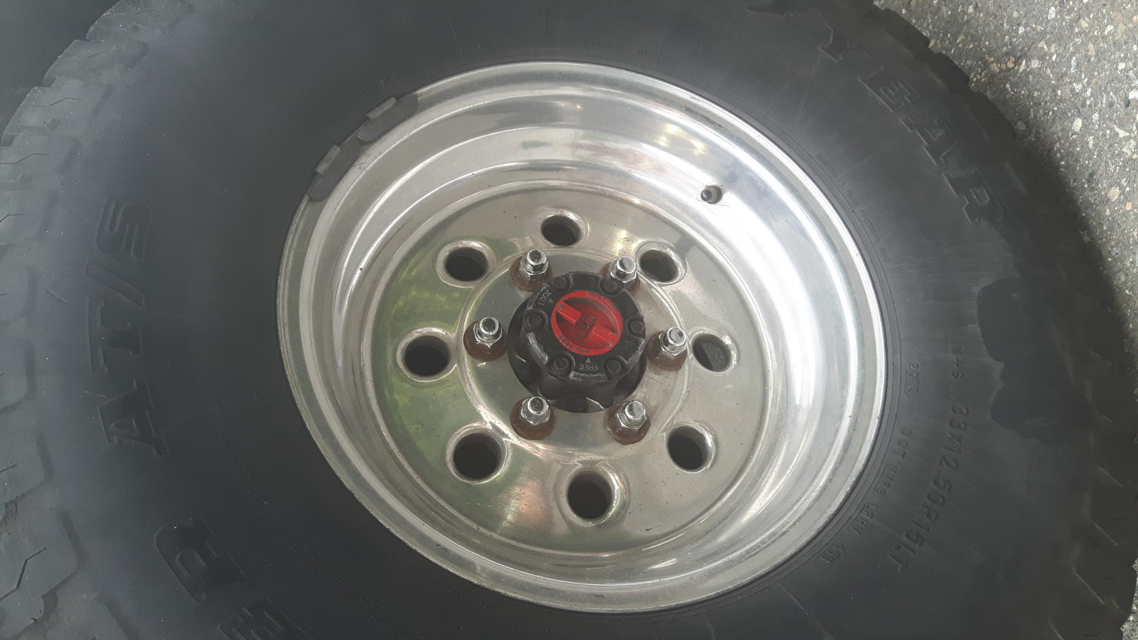

Does anyone know what size wheel is it don't have size on it. What size and backspace?
On 1988 4runner and don't think are stock.

What size are you looking for? the Diameter of the Rim? or the depth? Its a 15 as we can see from the tire, in terms of depth you would need to take the wheel off and see if there is anything that reads 15x?? to get that info. backspacing most likely wont be on the back but just take a tape measure for that.

As Frank mentioned, the wheel size/width should be on the back of the wheel with perhaps some other manufacturer markings. Offset or backspacing may also be on there if you're lucky. If not, you can still measure that yourself.
Offset is the distance from the mounting face to the center line of the wheel. Backspace is the distance from the mounting face to the inside rim of the wheel (use a straight edge laid across the inside of the wheel from rim edge to rim edge and then use a tape measure to determine distance from the mounting face to the straight edge. .....that's your backspace):
