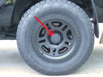

I think I figured it out.... That cylinder you see is probably a cosmetic "hub cover" that slides into the wheel (it's removable so they can balance your wheel on the balacing machine). Tap it with a rubber hammer. If it's made of metal, it got slightly rusted to the hub.
Is this what you are describing?

I believe some might be screwed on with hex nuts. So before you start hitting with a hammer, make sure that's not the case

Yes ATL4R your picture descibes it. But to make sure I will take a wheel off and take a picture. Thanks all.
I see nobody has answered you since your pictures went up but as posted above just knock them off with whatever means you like - fist/palm would be a good place to start. Maybe foot/shoe from there.
They will come off. They are not attached in any special way - probably just bonded due to a little rust as mentioned.
ATL4R - Yes, nice work thinking of the center caps. At first, I was picturing the calipers and the rotor.
Anyway, In all fairness to calcrc - I also have a set of Pro Comps and can tell you that the center caps from Pro Comp are tight, very tight...even without being rusted on. The caps are "thousandths" smaller in diameter than any other center cap (I have seen on the 4Runner).
When mine were installed they literally had to be beat onto the hubs both front and rear. To take the caps off I had to use a plastic mallet and a 24inch prybar. A simple kick or hit with a mallet is not going to budge these guys.
I traded my ProComp center caps out for another brand and they fit the hubs and my Pro Comp wheels perfectly.
In your picture, you have taken off the end cap on the center cap, the rest of the center caps will come off after you remove your wheel.
