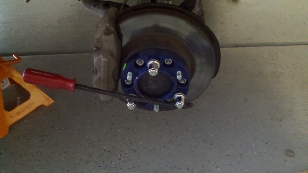

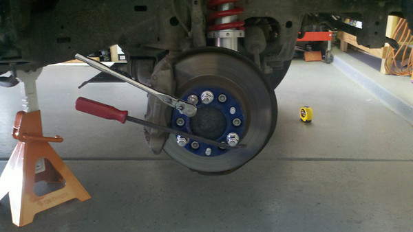

Here is a cell phone pic of what I am talking about, I hope this helps. This way you can hold the hub steady with one hand, torque the spacer nuts with the other hand and not damage the threads.
Good luck with the install this weekend!
