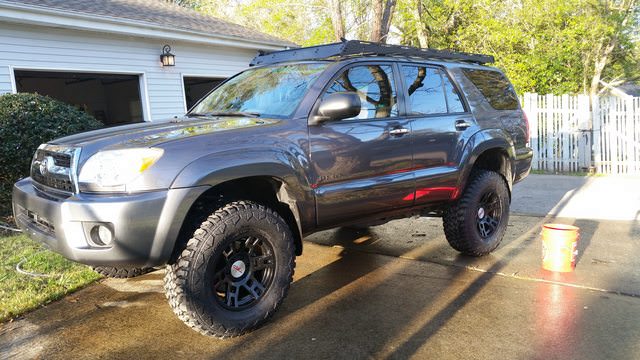

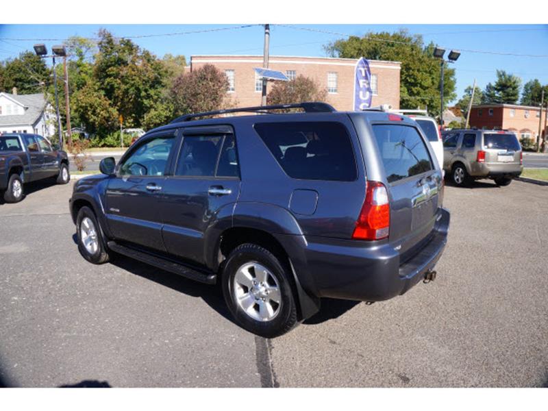

I tried to attach a couple pics, one is my starting point and the other is a truck I liked the look. Not sure if it worked or not.

Here is mine with that exact setup.
