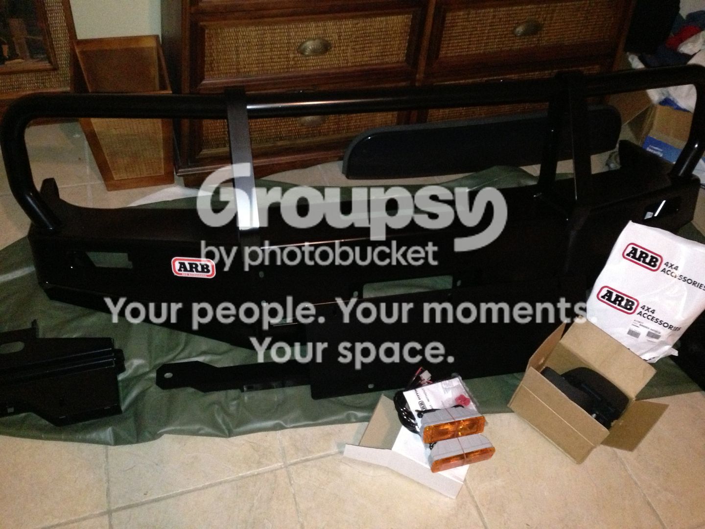

I read somewhere that the ARB bumper weighs 78 lbs

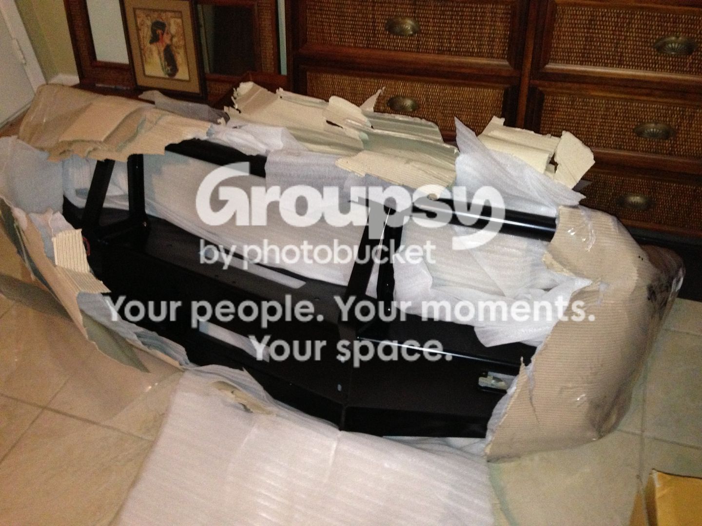

I just bought an ARB bumper (uninstalled as of today) and I think it weighs more than 78 pounds. FedEx had the reinforced cardboard box listed at 220 pounds, Autoplicity had 150 pounds as the shipping weight.
Even if the ARB is heavier than 78 pounds, you get to subtract the weight of the stock bumper. How much does the stock bumper and its related components weigh?
Of course, probably half of the 4Runner owners who get an ARB bumper also get a winch, so for a synthetic M8000 that is about 65 pounds and about 80 pounds for steel rope.
