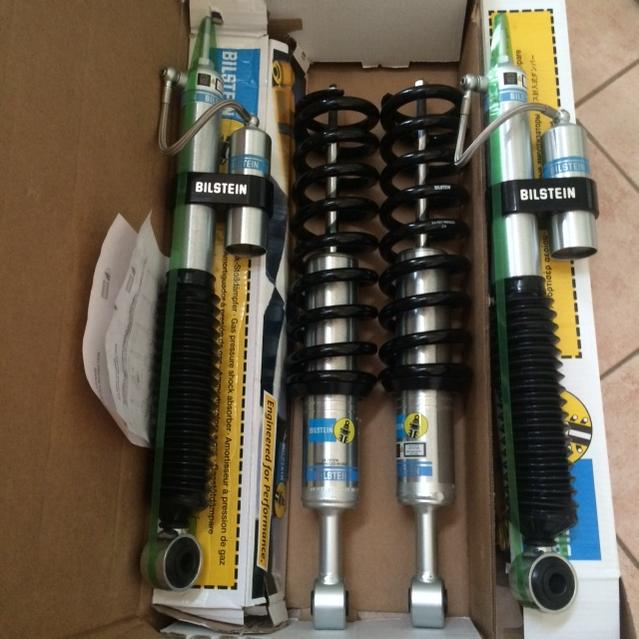

I received the 6112/5160 combo with the billet brackets. I'll be going with a #3 ring for a 2" front lift and 2" Icon spring rear. I'll be honest, I have not seen a bad lift on any of the pics yet. I may put it in tomorrow.
I was a tad bit nervous with threads stating more lift than expected in the rear 5160 and SAW coils. I called Bilstein and they had a good observation... the 1.5" SAWs include the weight of the third row in their calculations and gives closer to 2" with no third row. The tech I talked to said they even pulled a meeting of all the techs to discuss. Then he said, there should be no additional lift with the 5160. He also agreed the 2" Icons match the 5160s really well.

My truck will have a 90lb lab, a layer of dog hair, biking and fishing tackle plus camping gear running several Colorado trails so, I really a bit higher rear to handle additional weight.

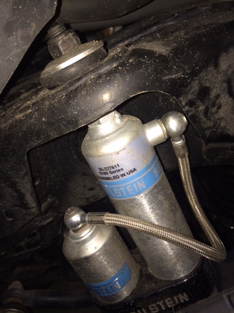

Here is my current reservoir placement. It went through quite a bit of snow today. This is the Drivers side and the reservoir is forward in front of the shock. The braided line is several inches away from the tire.
