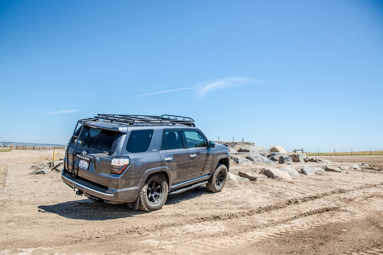

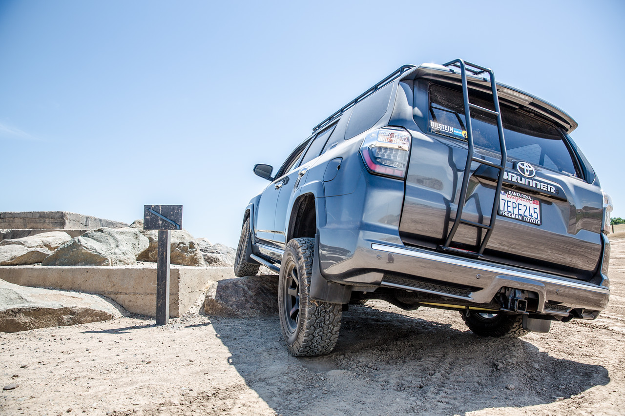

I know I was advised that these don't need extended bump stops and some claimed they had gone through their 5160 and recommend using extended bs to prolong the life of the shocks. From the look of the 2nd pix, does it look too compress w/out the extended bump stops?

I know I was advised that these don't need extended bump stops and some claimed they had gone through their 5160 and recommend using extended bs to prolong the life of the shocks. From the look of the 2nd pix, does it look too compress w/out the bump stops?
I can't see how you could damage them as long as you didn't remove the bump stops.
These have more travel from what I have been told, but as long as your bump stops are still intact and you didn't over compress your OEM shocks & don't have some long travel suspension setup, how could you over compress your 5160's?
Maybe I am looking at this wrong...can someone else chime in and tell us if I am in error....?
[MENTION=103267]Saker[/MENTION] - I think you are right because the stock TRD Pro has 5160s, stock springs and bumpstops. We wont over compress. You have the third setting and stock springs and looks to level nicely.

Since the rear is lifted, there's more room for compression vs when it's at stock height. And when it's flexing, the extended bump stop would help minimizing the body leaning(?) Maybe I'm overthinking this or not fully understanding how my suspension work off road.
Yes, currently it's at the 4th setting with 2.5 lift and rear SAW 1.5.
Overall, it's a lot nicer ride off road compare to Xreas. It may have felt better if I had aired down. (I need to get an on board air system) I do need to practice going slower and controlling my brakes better.. Not used to it yet offroad., especially over big bumps. Haha.
