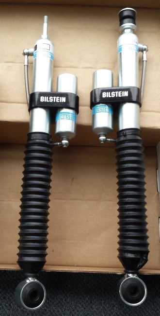

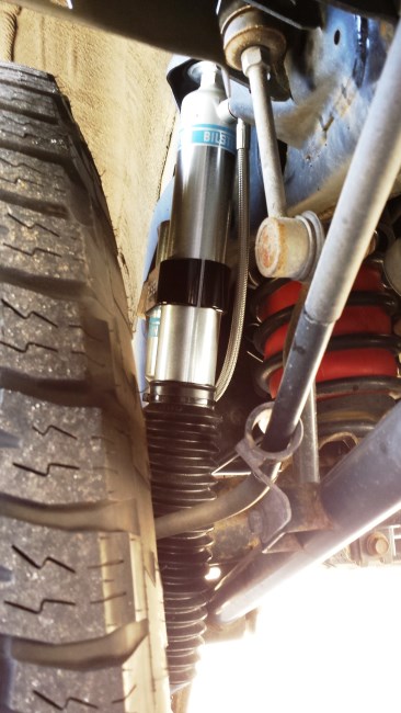

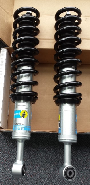

Installed front shock boots & rear brackets.
View attachment 154256View attachment 154258

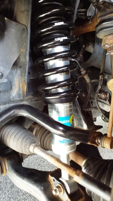

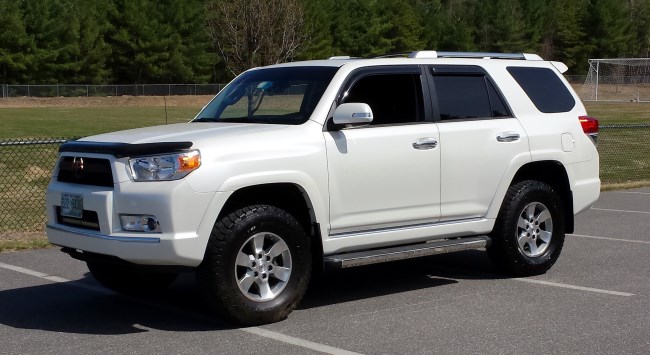

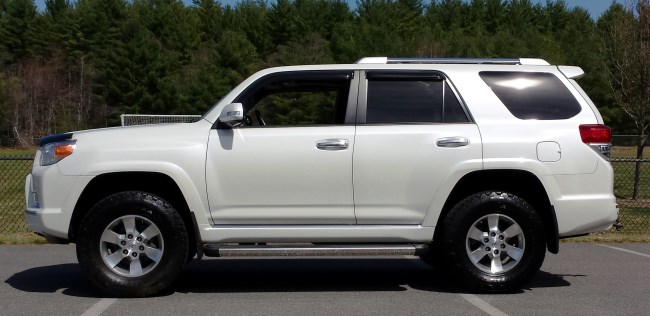

Installed today, can confirm 4th setting equals Daystar 2.5" spacer.
View attachment 154255View attachment 154257
Very impressed with the ride quality so far. Alignment is close, but will have it checked this week.
Rear is stock springs with Daystar 1.5" coil spacer.
Great stance!

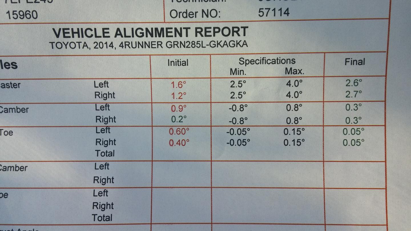

I'm currently in debate of whether or not I should get some UCA (current GB on the BR uniball) or not to go with my Bilstein setup for overall ride quality and to get my alignment in spec. But I guess I may not need them. Here's my alignment spec for those that may be curious. My setup is 2.5" lift on the 4th setting.

maxing out the caster but still in spec and overall pretty even on both sides.

It's not that I don't like my 6112, it's something I need to get used to, especially on road. I have yet to test them off road. Compared to the Xreas, I like the characteristic of the Xreas for everyday on road. There's less nose dive and better side to side/cornering performance compared to the blisteins. The blstein is obviously more comfortable and there's trade off. I wanted the lift to be more capable off-road and I'm sure I will be happy once I take it offroad. It's just a matter of time to get used to how the rig drives on the road. Also need to watch my driving around town, felt too loose for me. But hey, it's a truck. =) I guess I was under the impression that it preform better from the 5100s reviews and the 6112 was a step up. I guess that was mostly the SR5 guys. Most of them claimed that nose dive is eliminated and it was firmer and the Xreas guy didn't miss the Xreas at all. The truck is no sport car by any means, but I have taken turns on winding roads at moderate speed and surprise that it handles better then I expected. I may not feel confident doing the same with the blisteins. Offroad will definitely be a different stories.
Add you a set of Spidertrax 1.25 wheel spacers front and rear and you will get the handling back (and maybe then some, subjective) that you are missing in the corners. Widening the track will take care of that (side to side). Might need some trimming with your tires. It effectively raises your roll center for anyone who knows what that means.
^ that did cross my mind to get spacers, either that or run 305/60 tires. My previous set up was ~1" wider overall w/ -12 offset.

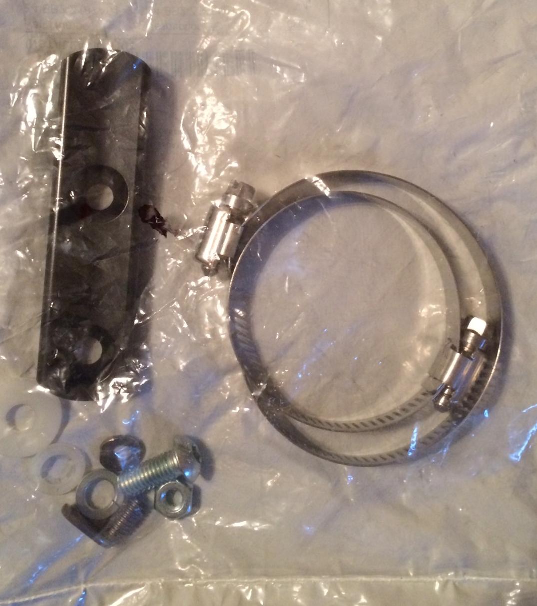

also debating if i should get the billet mount. The supplied L-screws for the bracket broke off.
[MENTION=107460]Magnetic4R[/MENTION],
As promised and for others that may need the Frame Bracket for 5160's kit part #, here it is!

I see pictures when at the 3rd and 4th notch in this thread. Looks like the 4th notch is providing consistent 2.5" of lift.

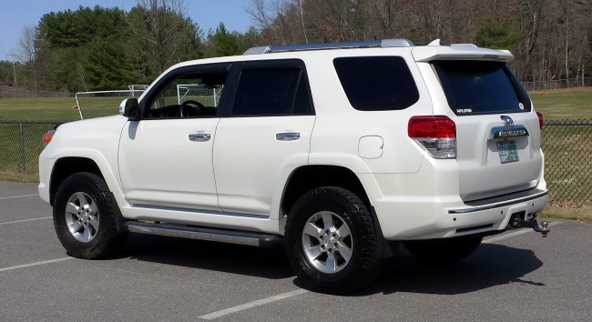

6112s on second groove, 5160s in rear with stock springs. I love the look and feel. I intentionally left some rake due to lugging around heavy camping gear, and i like the way it looks). :cool:
:driving:
:driving:
