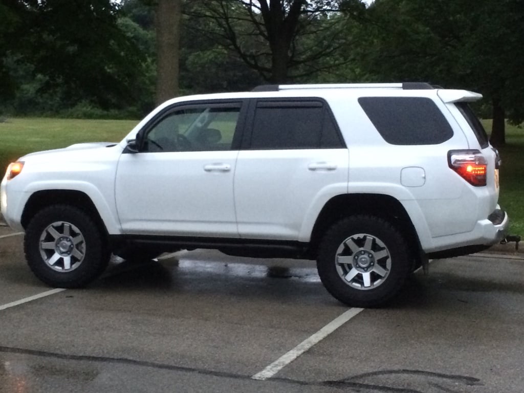

It's been a long wait but finally got mine installed tonight. Went with the 3rd setting and a daystar 1.5 in spacer in the rear. So far so good. It rides so much better than stock.
I am currently running 285/70/17 Goodyear duratracs with the daystar spacers (2.5/1.5). I am going to add some 5100's and Icon 52700 springs in the back.
From ur post it seems as though the front on the 3rd setting combined with the rear spacer leaves a slight rake. So, on the 4th setting this should eliminate your rake ?
In my case would you recommend the 4th setting to give a slight rake with the 2" Icon coils? I'd prefer to have these set perfectly from the beginning and not require a second break down.

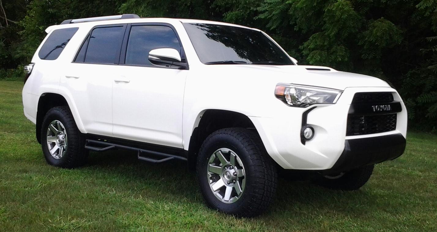

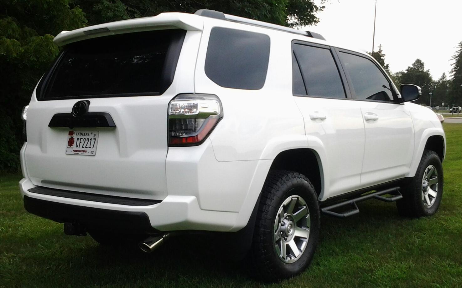

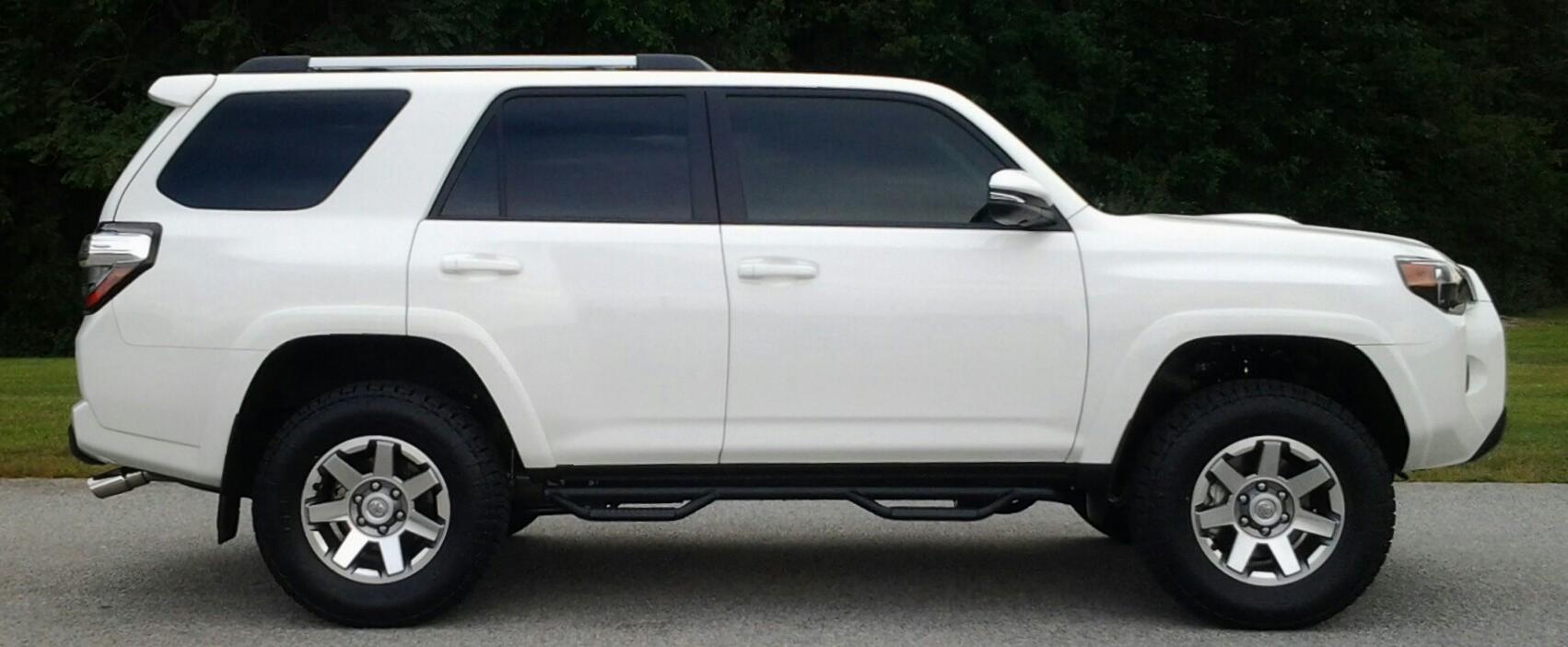

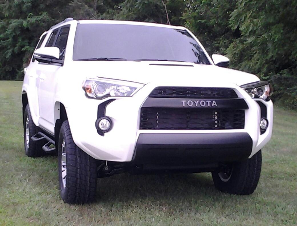

Bought this 2015 Trail new about a month ago. Have done a few mods so far. Just installed Bilstein 6112 yesterday. Getting an alignment tomorrow. 3 setting from bottom. Waiting on my Bilstein 5160 and then I will just run rear stock springs with AirLift bags
Couple more pictures.

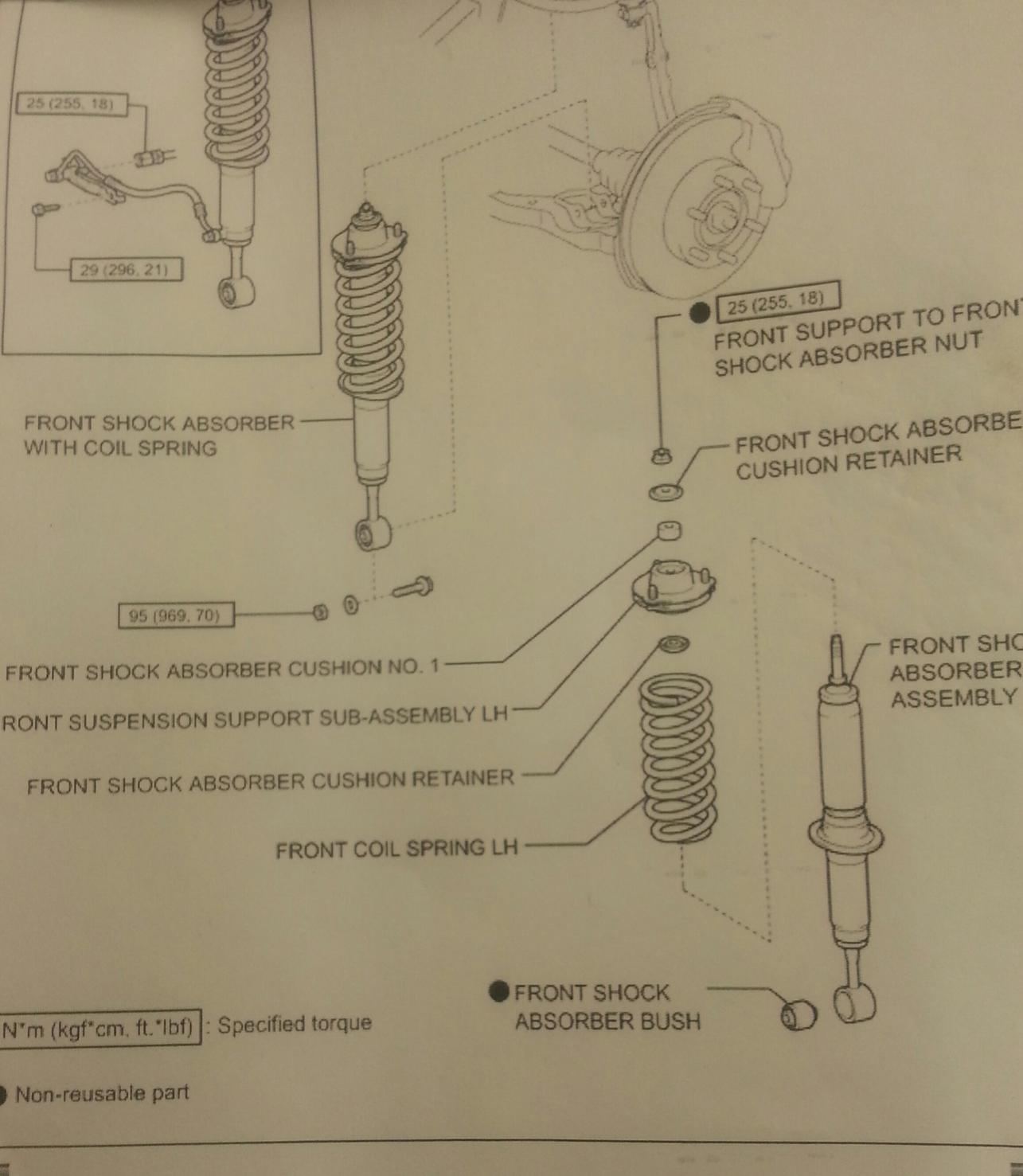

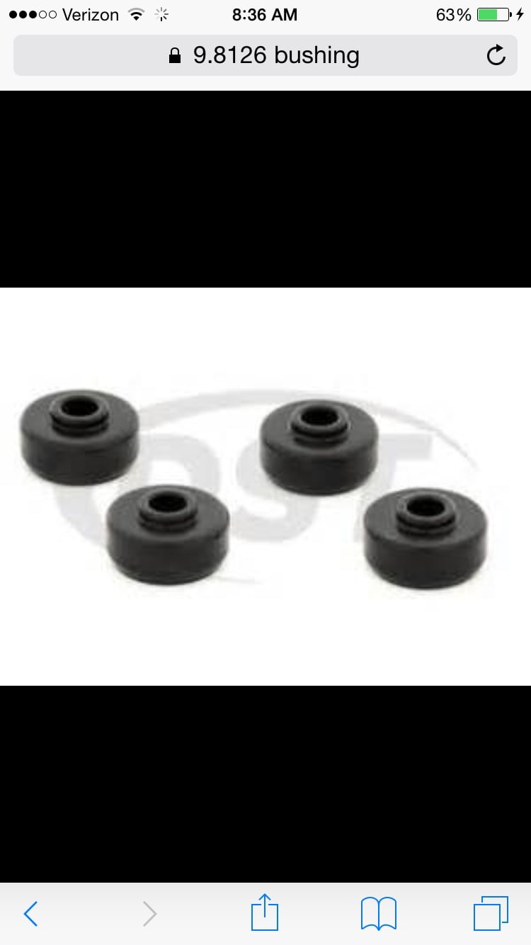

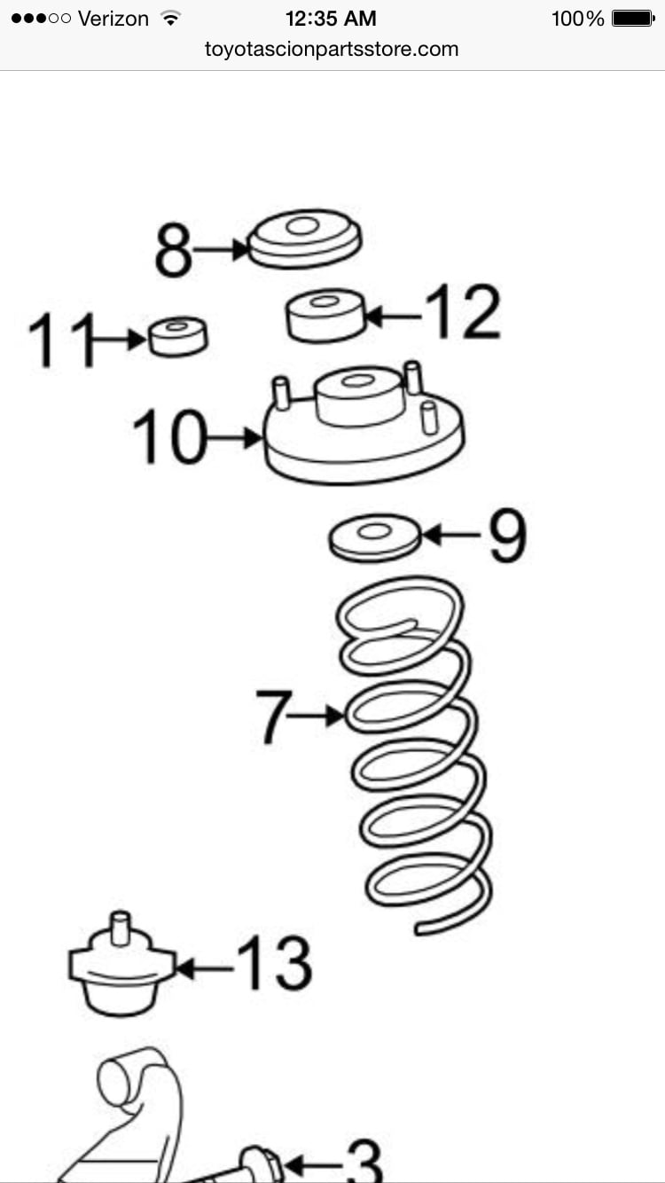

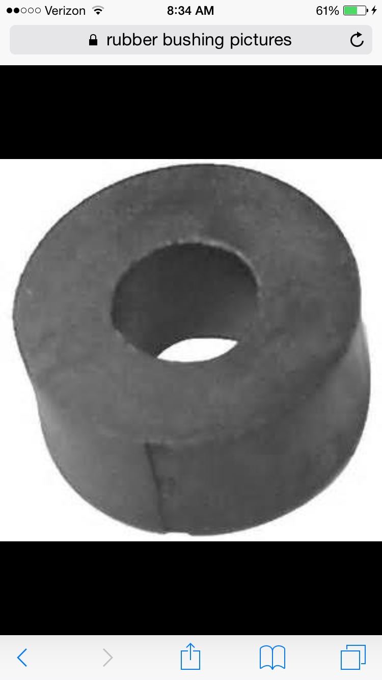

On the 6112's installation is there a rubber bushing that goes on top of the mount plate & another on the bottom? I have two rubber bushings and the two coil spring isolators. It's difficult to tell by the pics in this thread the assembly pattern.
The parts diagram only shows one bushing for the top and then a metal washer on the bottom.
Here is what I had
So, there isn't another bushing that the shock rod passes through & then pushes against the underside of the top plate? Only a washer..... The diagrams make it look this way.
The lower washer says "cushion retainer". So, I'd imagine there is a second bushing. Does anyone know if it's identical to the top bushing or does it have a small lip/raised nipple on it? Examples below.....
The second bushing was under the front suspension support sub-assembly. It stayed in place when I removed sub-assembly
I guess that is what I get for buying new top plates that are non oem. The top plates I ordered only came with the flange nuts. So, the washers, bushings and isolators had to be ordered separately. The diagram made me think there was only one bushing on top.
