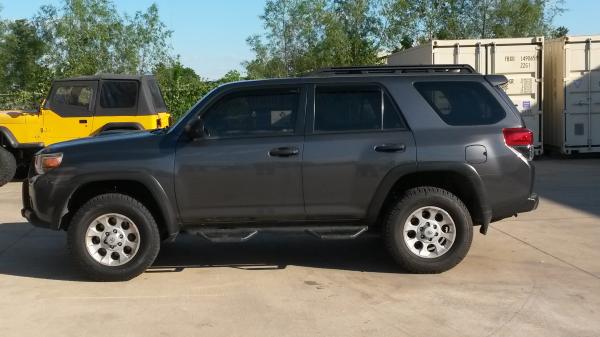

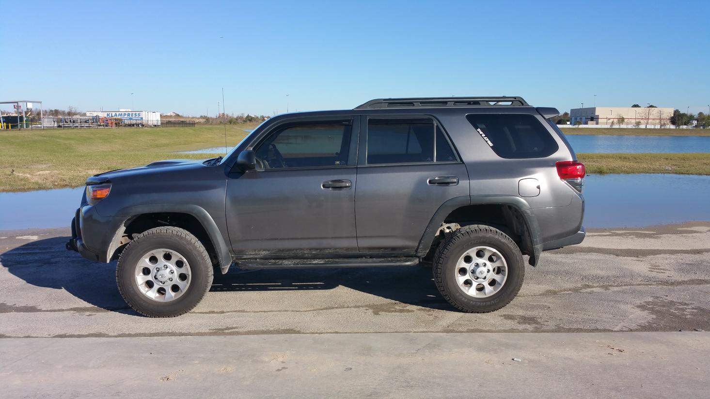

Initial setup as of May 2015:
6112s on 2nd circlip, and 5160s with stock coils in rear
Updated setup as of December 2015:
6112s on 4th circlip, and 5160s with SAW 1.5 coils in the rear
See attached
*tires did not change over this time. I do have aftermarket Camburg MOOG BJ UCAs on the front, a souther style speed slimline hybrid bumper, spider Trax wheel spacers, and shrockworks sliders now as of the December picture which i did NOT have as of the May picture.

*tires did not change over this time. I do have aftermarket Camburg MOOG BJ UCAs on the front, a souther style speed slimline hybrid bumper, and shrockworks sliders now as of the December picture which i did NOT have as of the May picture.
