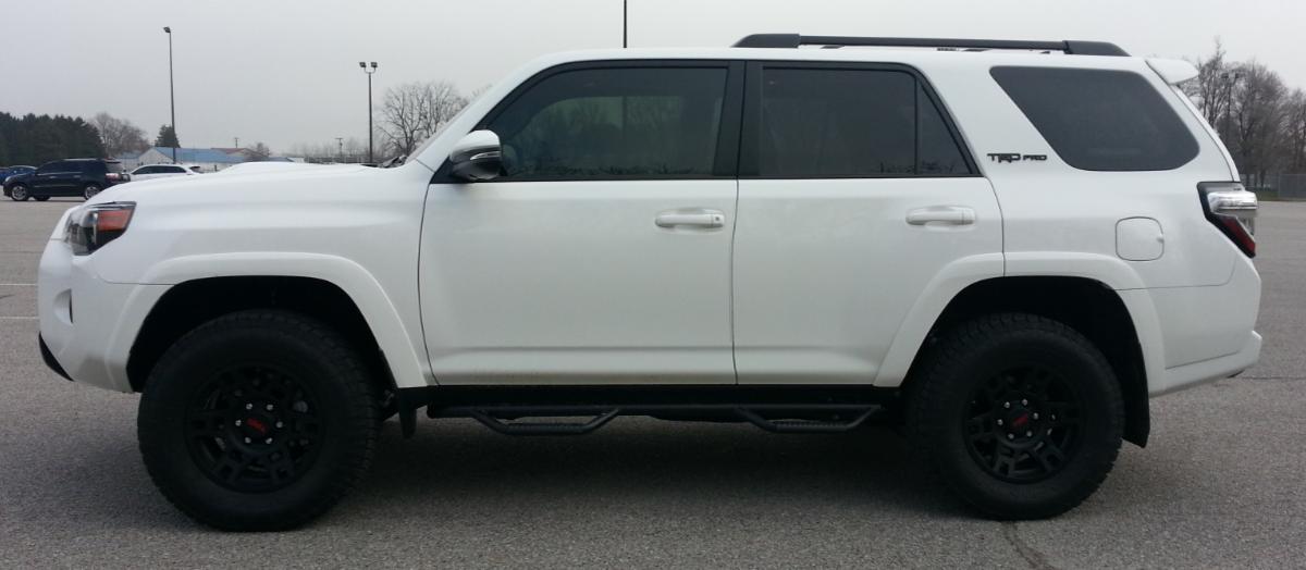

Not 2 inch springs but Bilstein 6112 set at 3 clip with AirLift 1000 set at 5psi. With this set up you can adjust your load according to needs. Rides great. Wont be stiff when you're not loaded down. Just another option

Yup! Love his setup. Just looking for another reference or two before I pull the trigger.

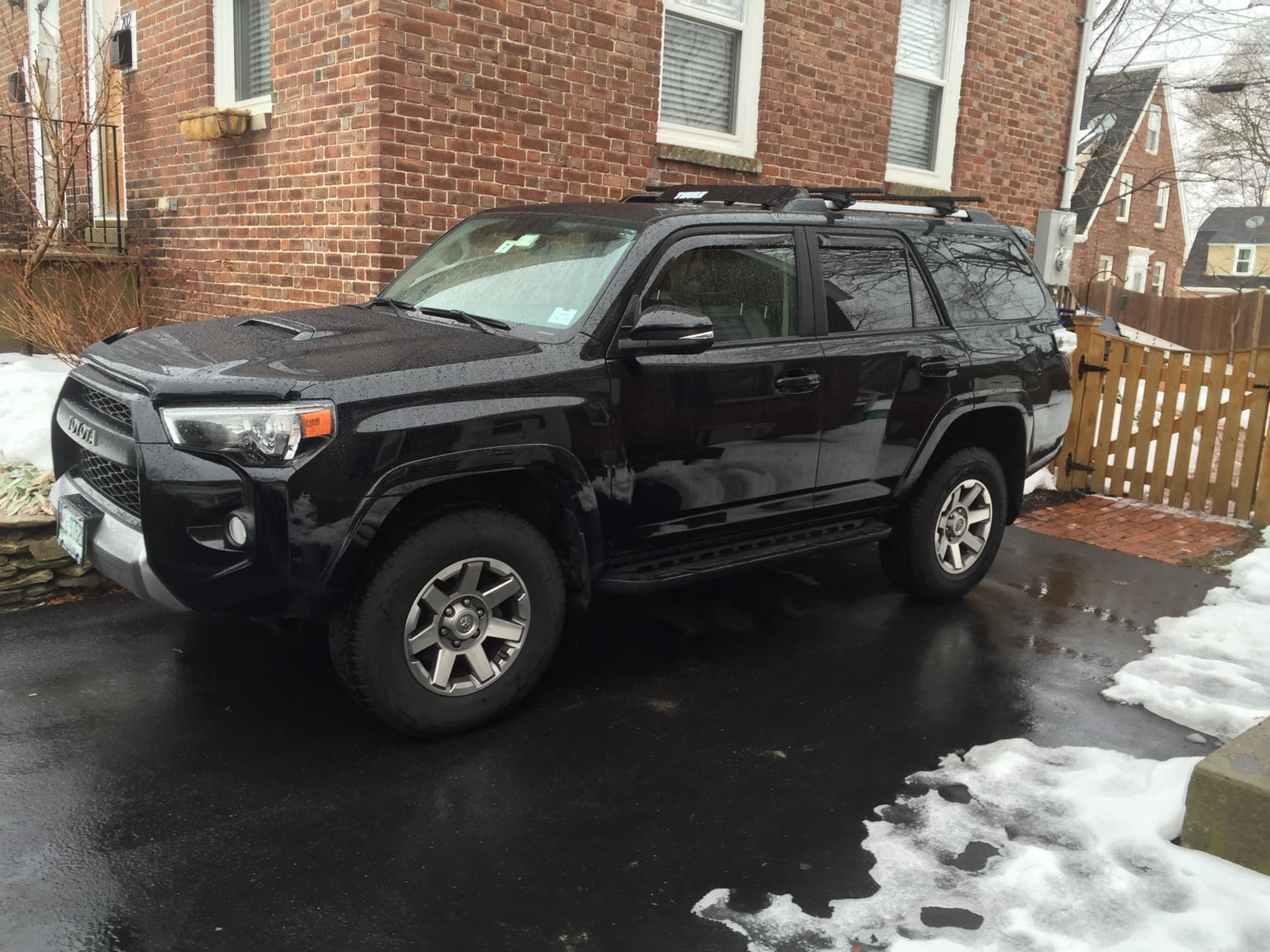

I'm finally feeling dialed in with my 6112/5160 setup on my '15 TEP. All my parts came in at separate times and I installed them as they came in.
In First, the 6112's on the second clip. I went from 34" both sides to 35.5" and it eventually settled a bit to about 35.25". BTW- the truck's ass end felt really squishy and un-balanced without the 5160's installed. I was not initially impressed with the 6112 and factory rear shock/spring.
The ride height change was barely noticeable and I wasn't really feeling how the ass end sagged with any kind of weight.
Next, Cooper AT3 255/75/17's and debated between 1" or 1.5" spacer or 2" spring.
Next, installed the 5160's. What a difference in ride quality. Finally a balanced suspension. As documented, a minimal to no change in ride height.
After setting it up on the lift and figuring out how often I'll be driving with my trunk loaded (trailer hitch bike rack and bike, dog, work gear, fishing gear, etc) I decided to go for the springs. Much thanks to [MENTION=117446]CSix[/MENTION] and [MENTION=109458]letzrace[/MENTION] for their recommendations. I was pretty set on the 3rd clip in the front gaining only 2", but I was nervous to go with such a forward rake. That said I really wanted to see how the springs could improve the ride over factory and spacers.
So, springs installed and 6112's changed to 3rd clip...
After about a week riding around with a loaded down trunk, the springs have settled some and I'm now at 36" front and about 38 1/2" in the rear. The ride quality with springs is great and I'm very happy going that route.
If you are looking for a more leveled look and wanting to stay under 3", I would recommend the 4th clip in the front and the 2" springs. I may do this in the future, but I need to research a bit more on how that will affect the KDSS. I'm hearing multiple opinions on that.

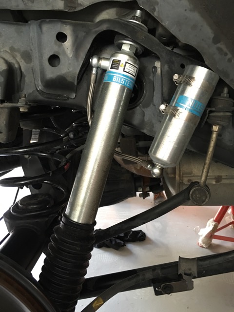

I noticed traces of oil on the garage floor and realized the rear suspension was covered with oil. The shocks lost the gas and most of the oil in those few days which was hard to believe given Bistein reliability and warranty. went today and took them off and put the stock shocks back in so we can use the truck. I noticed that most of the oil was coming out of the hose connection on the shock body and later realized that it was not tightened the guys who did the install never touched it and the installation instructions never mentioned anything about checking them or tightening them as part of the install procedure did anyone experience this (I very much doubt it) this is suppose to be torqued to spec in the factory to avoid damaging the seals unless it was produced early Monday or late Friday???

Contacted the warranty dept, person respond so far does not give me a happy fuzzy feeling that they will help. After I sent pictures of the install which does not tell the whole story (2d picture vs human eye)
See below
The hose fitting appears to be contacting the chassis during the cycling of the suspension. Can you look for witness marks on the frame for evidence of contact? We also noticed the upper washer was installed upside down per the instructions and the bushing appears to be over-torqued. Thank you.
While the fitting does not and has not touched the frame since they are positioned inside the gap between the frame and frame plate, I was with the installer and he/ we followed the included instructions to the T. Everything was done correctly. But even is the bushing is installed upside down, for sake of argument, that does not cause the shocks to leak and spill its guts out. Does it?
