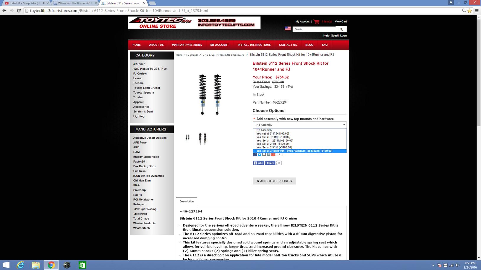

Here is what toytec shows for lift amounts. Mine is on the second clip up from the bottom (meaning 2nd above the stock height setting or the middle clip) and was damn close to 1.25". According to this you would need a spacer for the full 3"
Here is what toytec shows for lift amounts. Mine is on the second clip up from the bottom and was damn close to 1.25". According to this you would need a spacer for the full 3"
You seem to be the only one that achieved that then. I'm on the third clip (right in the middle) and got 2".... As did EVERY other person in this thread. What toytecs website says is no different then what bilstein says.
Listen, I'm not saying this is the be all end all this is what you should do or die. I'm simply just stating what has been said by EVERYONE in this thread. As I took the advice from the people earlier in this thread. I was told the middle clip( 3rd clip) labeled 1.25" got you 2" of lift, and guess what. That is exactly what I got. I don't need a website or chart to tell me what I "should" get.

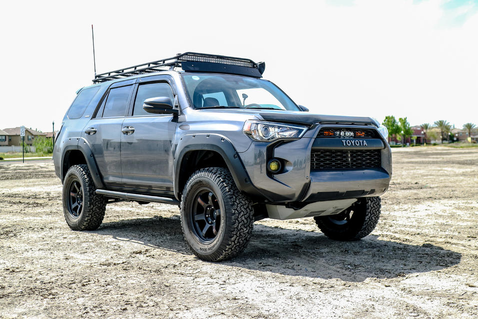

So, After installing the rear Icon Overland, I've been itching to raise the front to the 5th notch. I feel so much better and it looks great. =)
