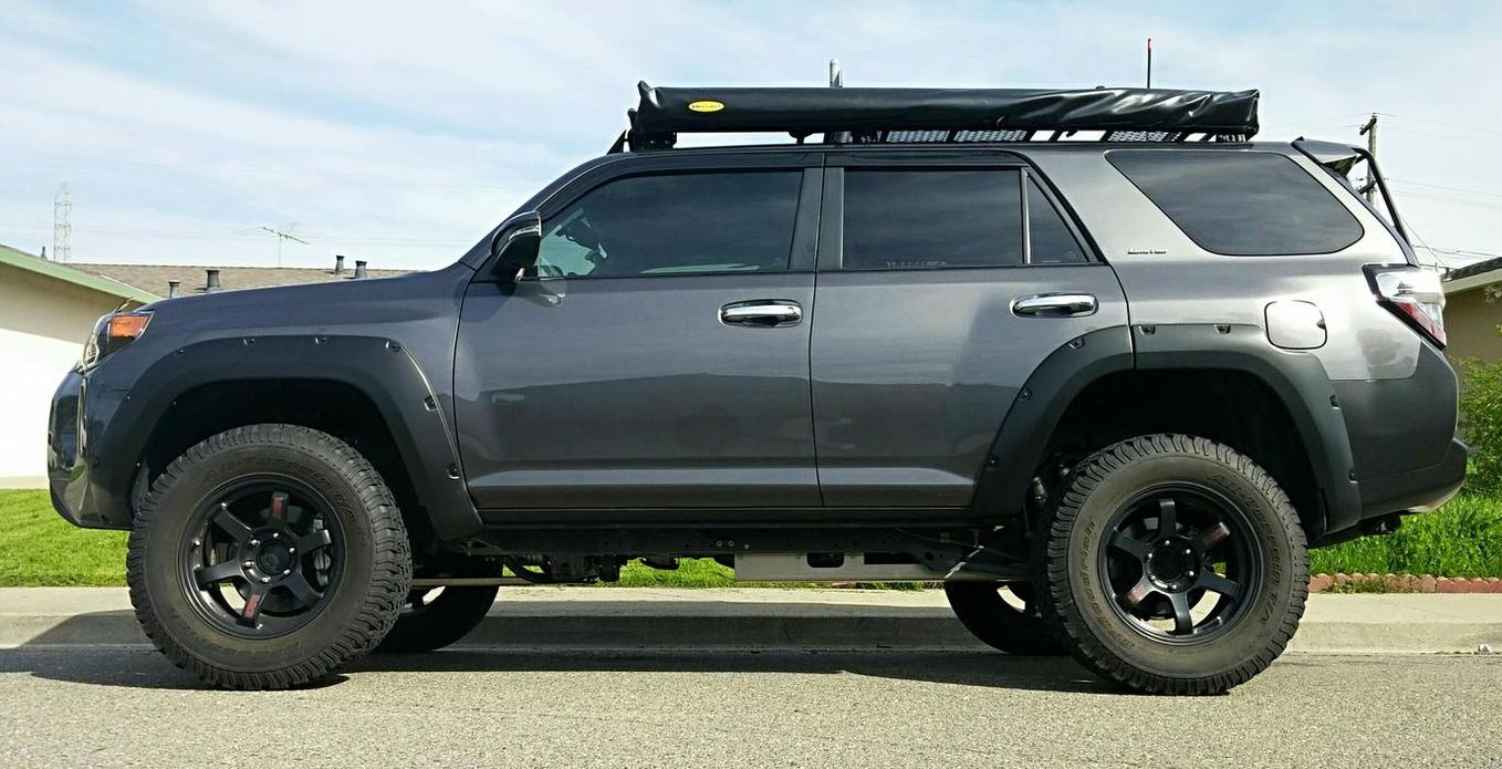

Can anyone with the 6112s at the 4th notch post more pics please?
I'm currently on the 4th, planning to go the the 5th once my UCAs come in

Which clip on the 6112 did you use to get 2"? I'm at the 3rd notch with the SAWs 1.5" in the rear and I have too much rake. The SAWs gave me probably at least 2". Looking at getting new UCAs so I can go higher in the front and get closer to level, if not fully level.
3rd Circlip groove will raise it 2" over stock.
Yup, that was my expectation. Unfortunately I didn't get accurate measurements before my lift so I can't confirm, but the SAWs definitely then gave me over 2" in the rear because I still have a decent rake. Oh well...time to go higher....
From what I've read SAW's give an average of 1.5" with 3rd row, and average of 2" without. I guess it's an excuse to add a rear bumper!
