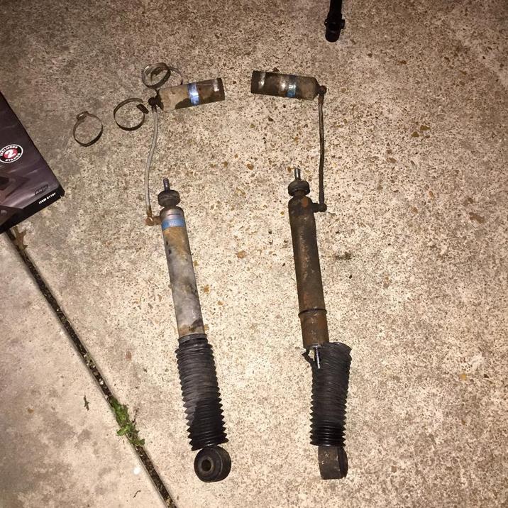

I was reading through [MENTION=50186]adio3x[/MENTION] build thread and he put the 5160s through the ringer as you can see from the pic that I stole from his thread. Here are a couple quotes from his thread that I thought people here would benefit by reading. I guess Im going to be picking up some rear bump stop extensions.
Those were my 3rd set. Probably got about 20k out of each set. Word of caution, get extended bump stops if you want to run those 5160s. Toytec stopped honoring my warranty after the guy that I had been working with left after the 3rd year. Told me to talk to Bilstein and they were saying it was installed incorrectly, which is BS.
I never had bumpstops on while I had the 5160s on, which was my first mistake. I put them through the ringer, very harsh desert bombing in utah & very flexy off cambered rock crawling & the shocks kept bottoming out and spewing oil. I would get either a 2" or 3" metaltech bumpstop, I have the 3" right now with my icons.

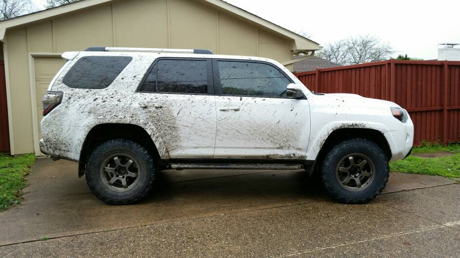

Pics are on a slight decline, nose down in the driveway.

I had the same thoughts that you did. 3rd clip up front with Icon 2" in the rear. I'm also carrying about 150lbs in the rear with me at all times. Hope this helps. Oh, also have 285/70-17 KO2s.[emoji41]
Thanks for the pic. I ended up going with the 4th clip and had to get the BOSS rear shocks with remote resi as they were out of stock of the 5160's. Also ordered 285 duratracs so mentally preparing myself to cut our new vehicle haha. I'm up in Canada so should hopefully have everything in a week or so.
