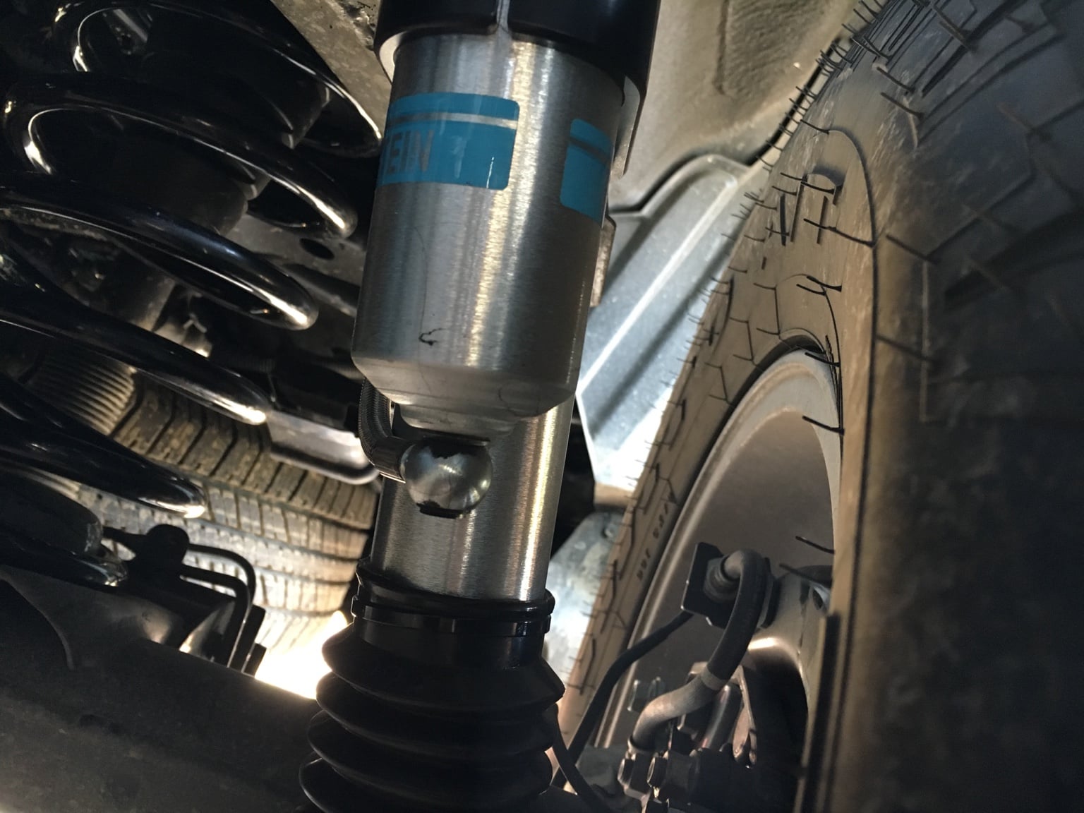

I just put mine on this week. Went with 5160s in the rear paired with Wheelers rear springs. They are copies of the Sway-A-Way springs Expedition Portal liked so much, but are no longer made.
Impressions after a few days are very positive. I can only compare it to stock and my friends 4th gen on OME, but its every bit as smooth as the OME system. Brake dive is virtually gone. My wife was concerned but after driving it on the pothole filled roads she gave the thumbs up.
Set on the 4th clip.

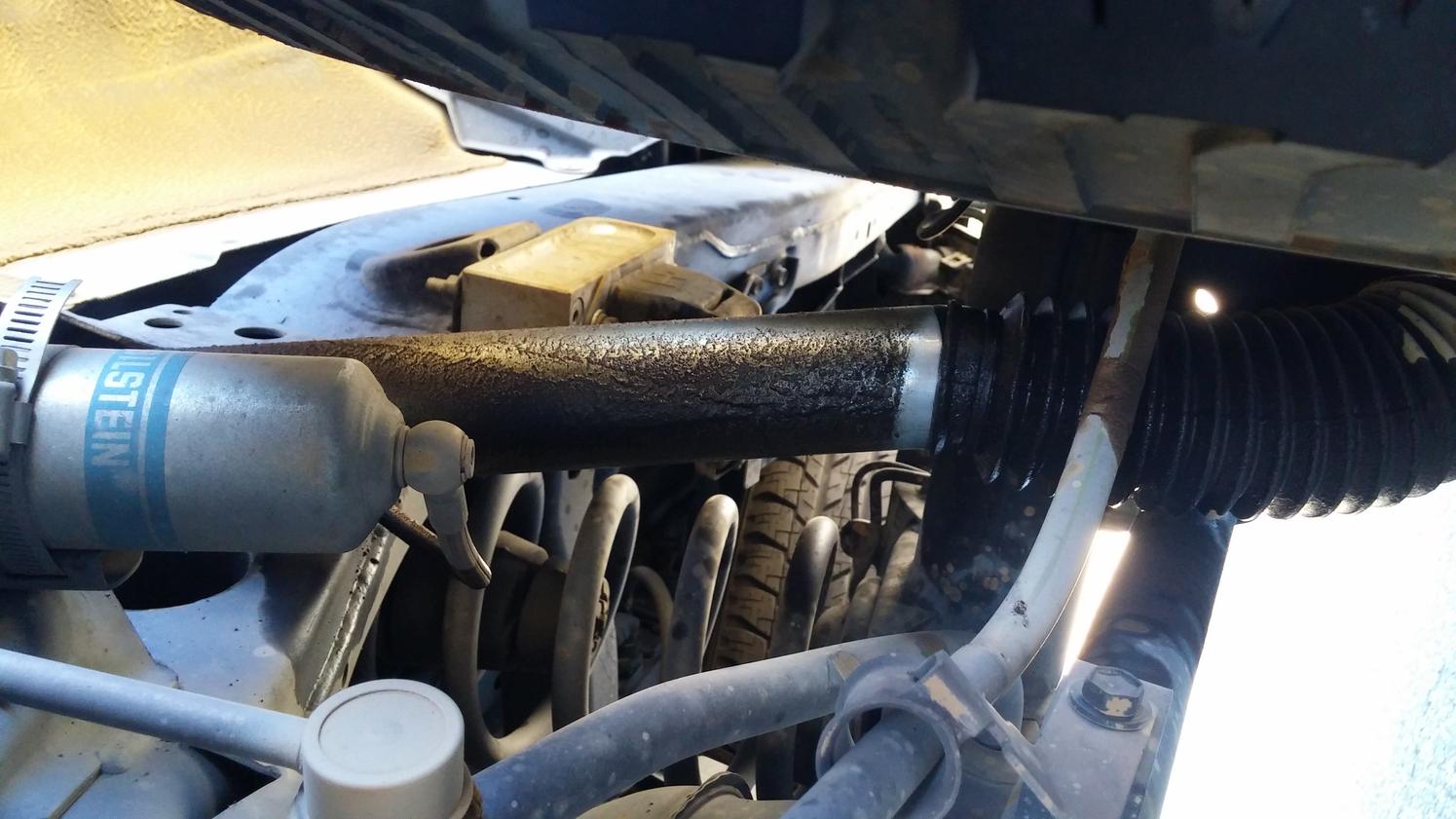

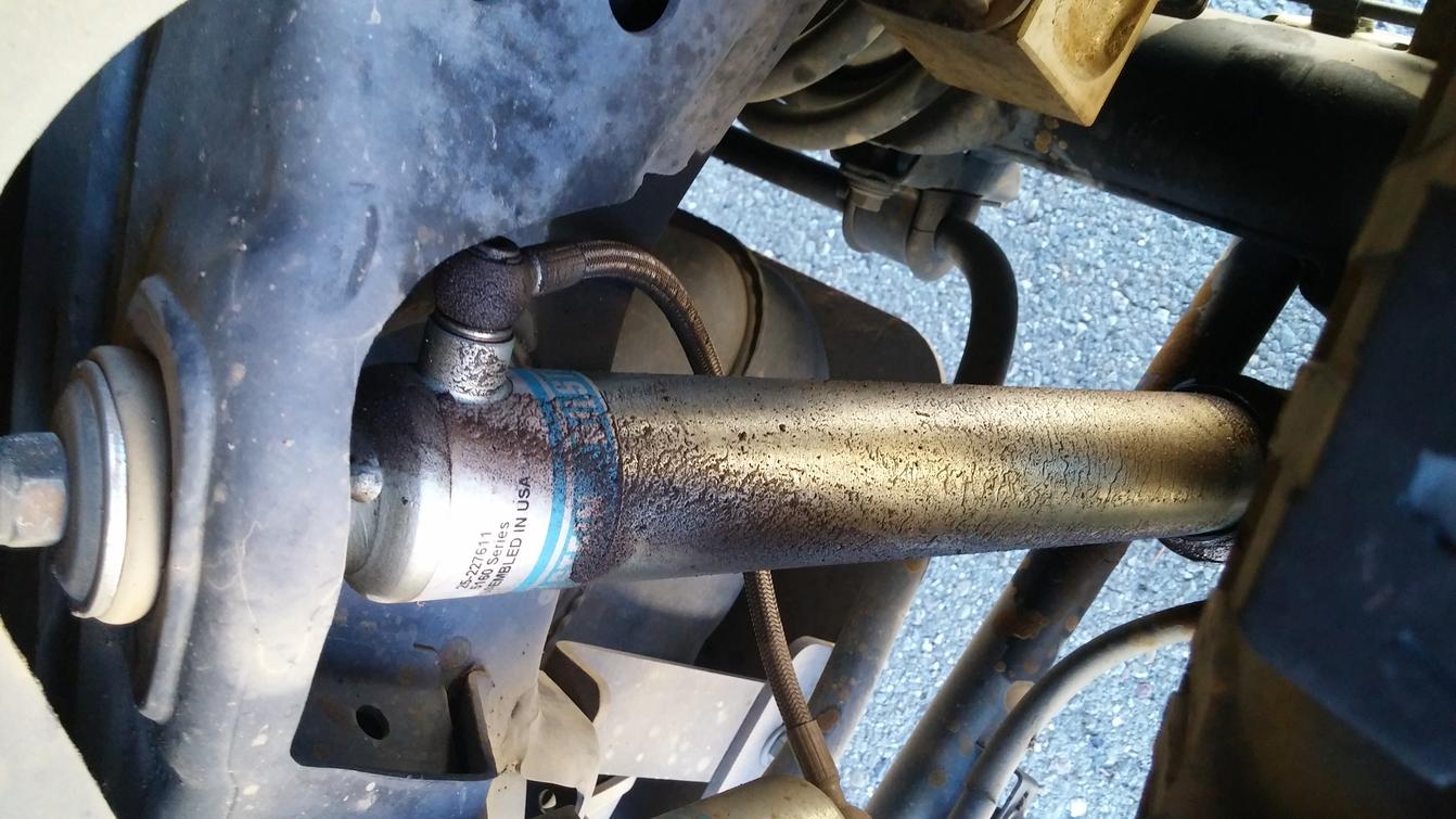

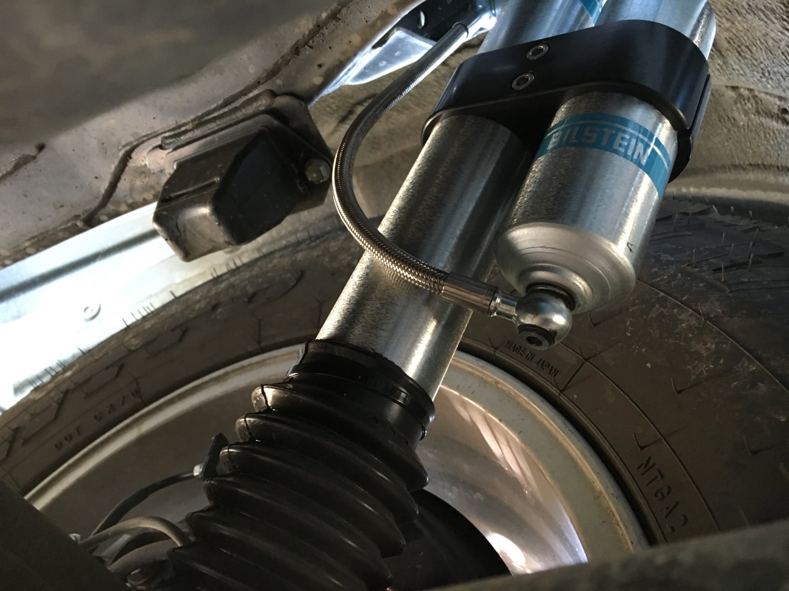

Almost forgot to mention, when I started the process I noticed hydraulic fluid at the tip of the reservoir:
And while I was on my test drive I got out to check how things were in the back and I could hear the shock fluid in motion... Seams like the shock is leaking... No Bueno. I haven't done any off roading since purchasing the truck, just have been using it as a daily driver. I'll send an email over to Bilstein tomorrow or soot see what they say.
Let me know what you guys think.
I had the same problem and my reservoir eventually leaked all the remaining fluid out. Still survived a week in Moab though ;) Get it warrantied!
Thanks for the heads up... Will do!
It doesn't look like it's leaking all that bad but I would definitely keep an eye on it. Also, I would try to rotate that resi so the hose isn't up against shock so it doesn't rub a hole in the hose.
