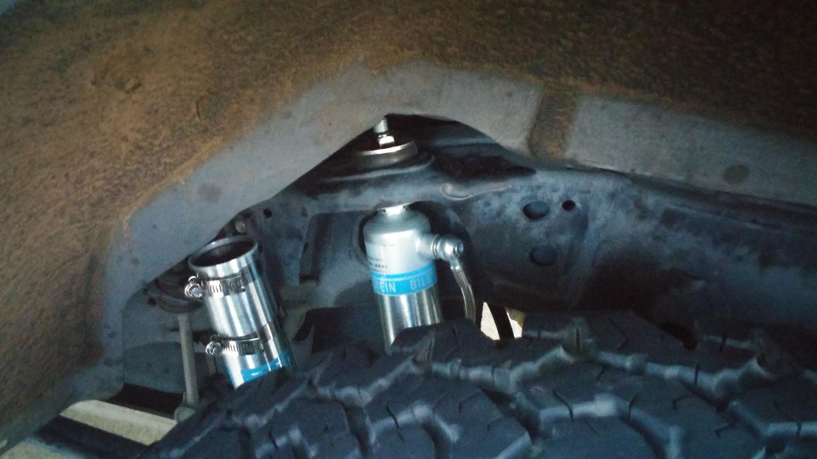

Hi Guys, I wanted to check in on this thread after a long hiatus. I installed by 6112/5160 setup back in February 2016. After reading all the issues, I decided to take a good look at the setup. To my immediate dismay, I noticed a great deal of corrosion on the shock body of the 6112's. I am located in NH where the roads and salt/sanded, but I was shocked to see how much corrosion has already occurred. What is more concerning is that one of the shock's top portion (the cap of the shock body, if you will) has cleanly separated from the body and now floats above the shock body since it's still connected to the piston rod.
I've contacted Bilstein and they recommend I use their deposit/replacement, but they don't cover labor. Err. Love the way this setup rides, but after the corrosion and the defect making me wonder if I chose the best option.

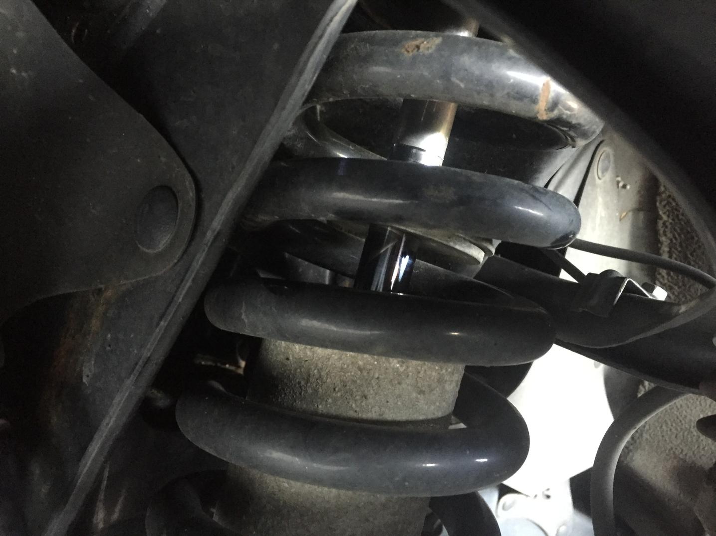

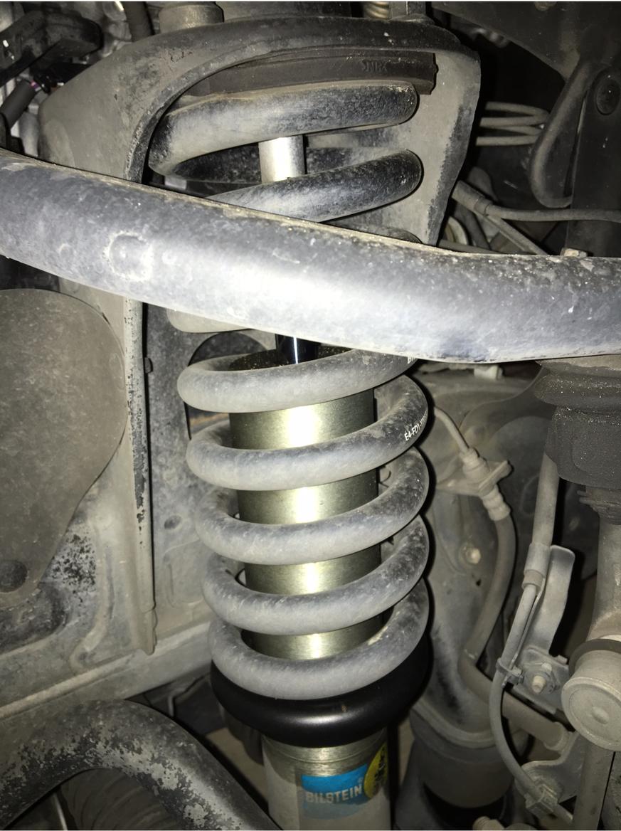

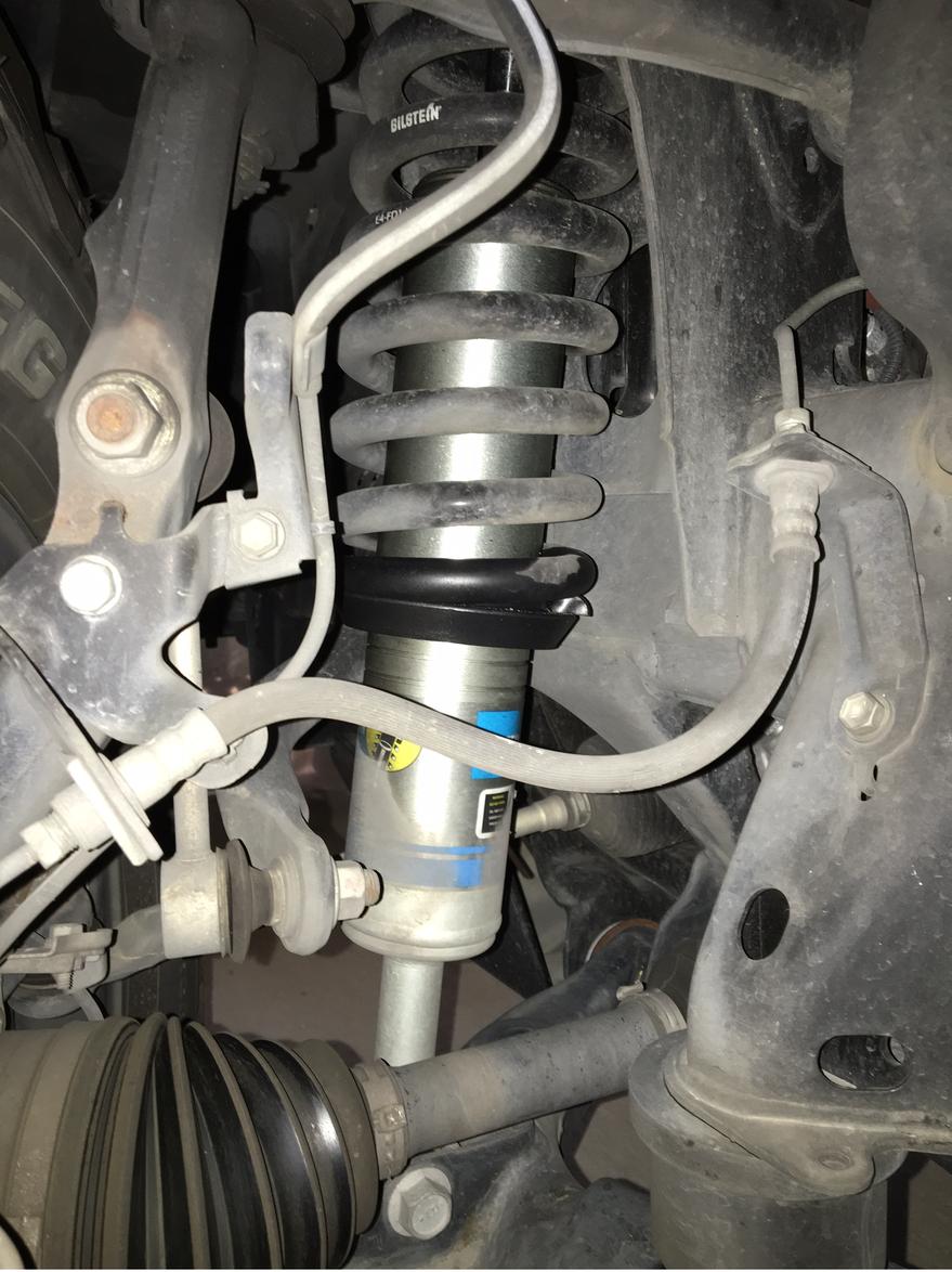

I have been in contact with Mike and Richard at Total Automotive Performance [MENTION=120150]TotalAutomotiveLV[/MENTION]. They have contacted Bilstein in my behalf and have forwarded the following photos to Bilstein.
Now I need Bilstein to do the right thing. My T4R is a daily driver and I cannot afford to have it down while a shock is evaluated for warranty.
Photos in Order:
1. 6112 - Drivers Side Front View
2. 6112 - Drivers Side Rear View
3. 6112 - Passengers Side Front View with no leakage
