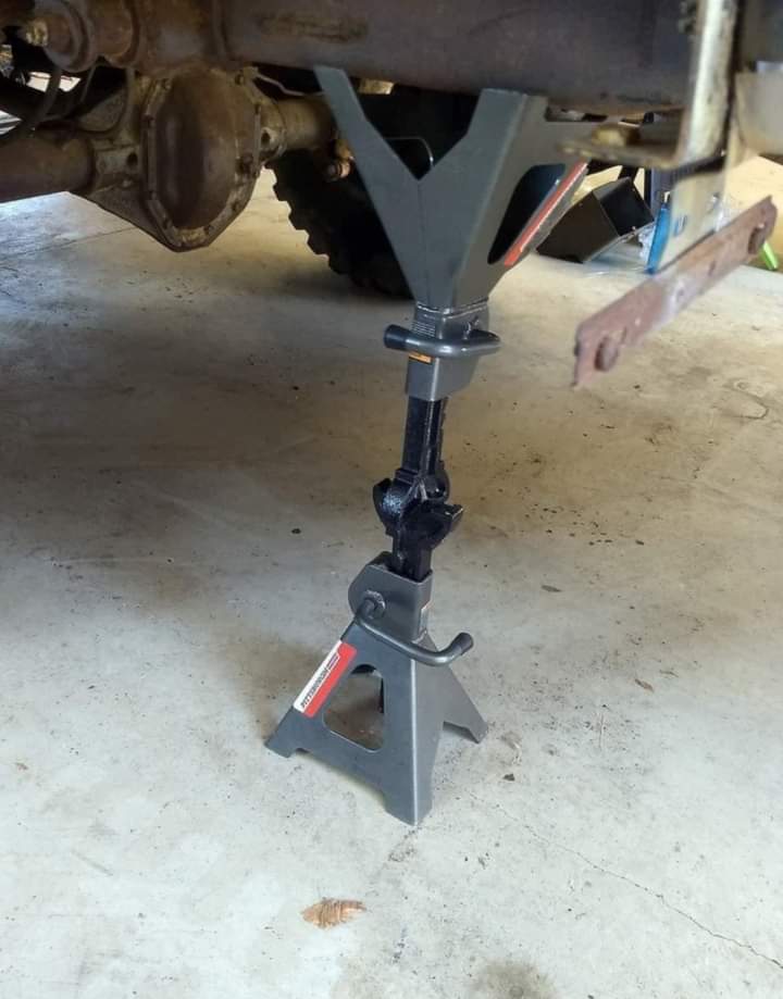

<a href="https://imgur.com/7yc5D8x"><img src="https://i.imgur.com/7yc5D8xl.jpg" title="source: imgur.com" /></a>
<a href="https://imgur.com/ivnzEgn"><img src="https://i.imgur.com/ivnzEgnl.jpg" title="source: imgur.com" /></a>
Ok.. I never saw the jack arrows. Those points are standard frame jacking points. :)
As your 4 tires are the contact points for the vehicle weight distribution when driving down the road.
You can see that the Jack points are near the axles. :)

I hope nobody jacking their 4 runner up like this? I mean those jackstands were recalled for goodness sake.. ;)
