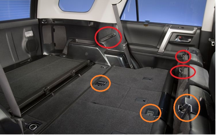

Fold the seat down and take a look where the latches are (should be metal to metal contact).
Should be two to four spots. (One on the side panel of the vehicle which helps the seat recline or sit up straight, and two spots below the seat itself. You will have to pull the tab so the bottom portion of the seat folds forward.)
Grease or WD40 on those parts and you should be good to go. Apply a bit more than you usually would. I did this about 1.5 years ago and I haven't had the sound come back.
Edit:
Found a quick picture online. It's the wrong side, but it will give you an idea where to look.

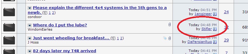

All I know is the title reads "Where do I put the lube?" and [MENTION=102338]Stimulant[/MENTION] was the last user to make a post:pound:
