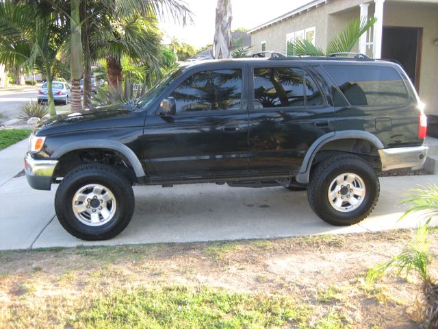

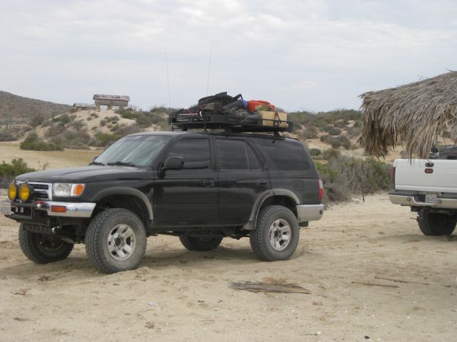

Damn if that's the list of part you getting with ordering that Im probably going to pull the trig.. Do you have any pics of your set? How high does the rear sit? would I need to get some kind of leveling kit?

Just a few pics. Sonoran steel is a great kit, drives very nice on the road, is ok for off road but not for pounding the desert like a race car. I replaced my rear bilsteins with the landcruiser 80 tokkico trekmaster shocks and like them better, they let you carry a bit more weight and and handle the off road stuff better. My rig has 270,000 miles on it , and it has more baja miles on it then most, still runs and drives excellent. Trying to make it to 300,000 miles before i replace her for some silly reason. Can not go wrong with the sonoran steel kit, good bang for the buck.
