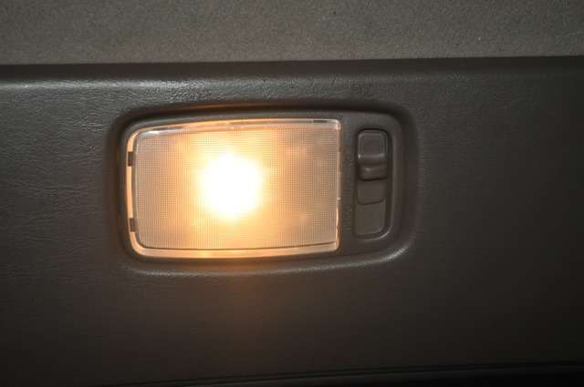

On my 1997 Toyota 4Runner, the rear inside roof panel light bulb lights in the "On" position (so I know it's good); but the light won't go on in the "Door" position.
I ran my hand all around the door and didn't see or feel the switch that actually turns on the rear light when the door is opened.
Can you advise me what the problem may be?

First do an easy check of the wires between the body and liftgate. Simple enough, pull up the boot and look for broken wires.
That's what was wrong with both my rear defrost and door light.

What a coincidence. I have just registered and this was about to be my first post. And thanks for the replies, I didn't know the switch was inside the lock mechanism. I will check it out.

where did you splice the wires? In the rubber boot? In the plastic holder between the two rubber boots, attached to the tailgate, and under the roof molding?
How do you get all that apart to splice them?
I took the light cover off and undid the screws holding the light in. The plastic trim piece pops off once those are out and just slip the light assembly through the hole to let it dangle. Next I pulled the broken wire down til I could reach enough of it to solder just enough extra wire to. Next I moved the boot up the wires and out of the way as well as the plastic piece, which pops out, and soldered the bit of wire to the other side of the break. I prolly should've covered it with some heat shrink or something but electrical tape was what I had and what I used. The other cracked wires I wrapped with electrical tape.
There's prolly a better fix, but that's what I did.
