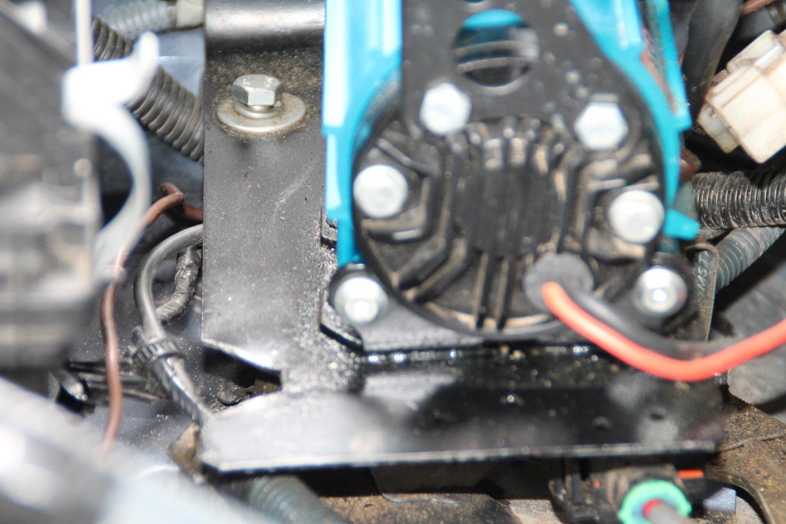

I put mine behind the CAI and fabricated/butchered my bracket out of galvanized truss plate from home depot. PIA and in a hurry because I wanted to get it done before a trip. Looks like crap, but it's solid. I wish I had planned better and gone with the Bandi or Slee brackets. Might change it out..........

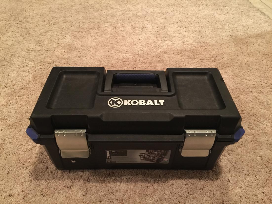

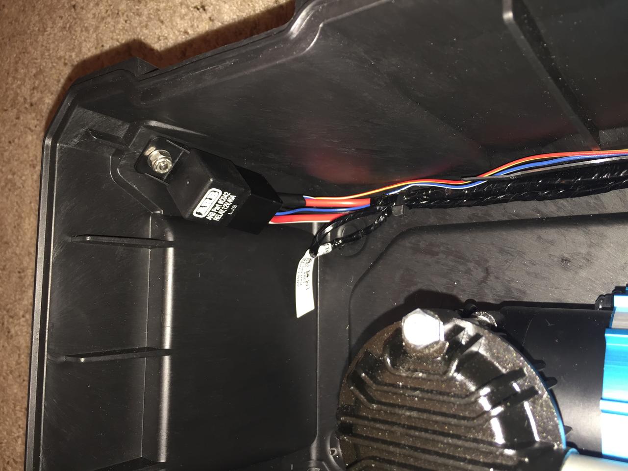

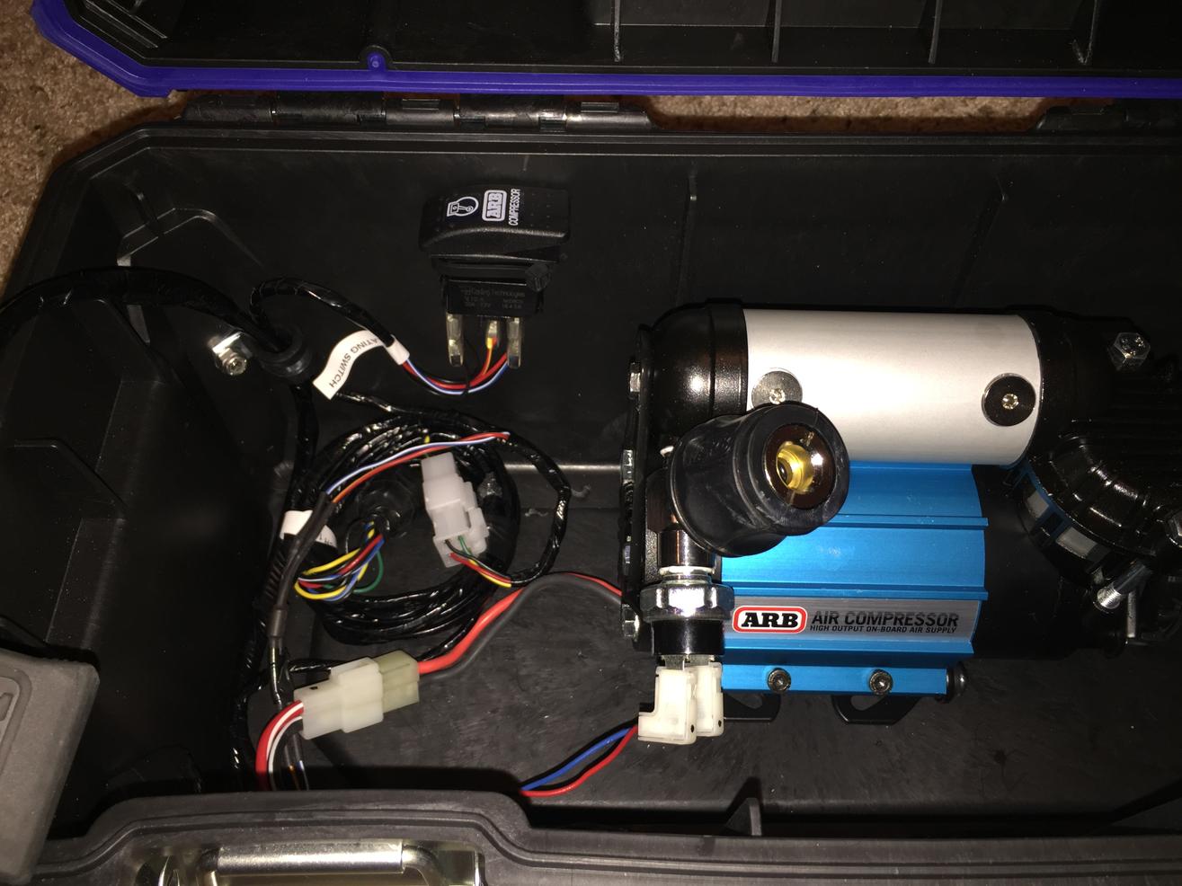

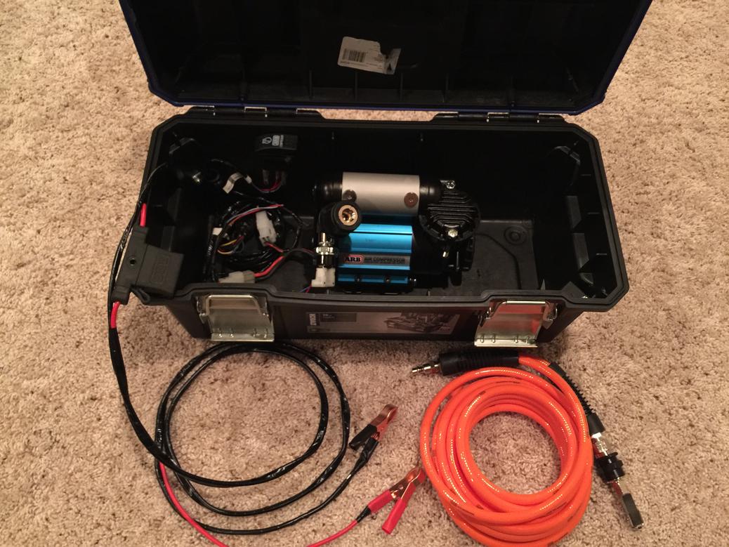

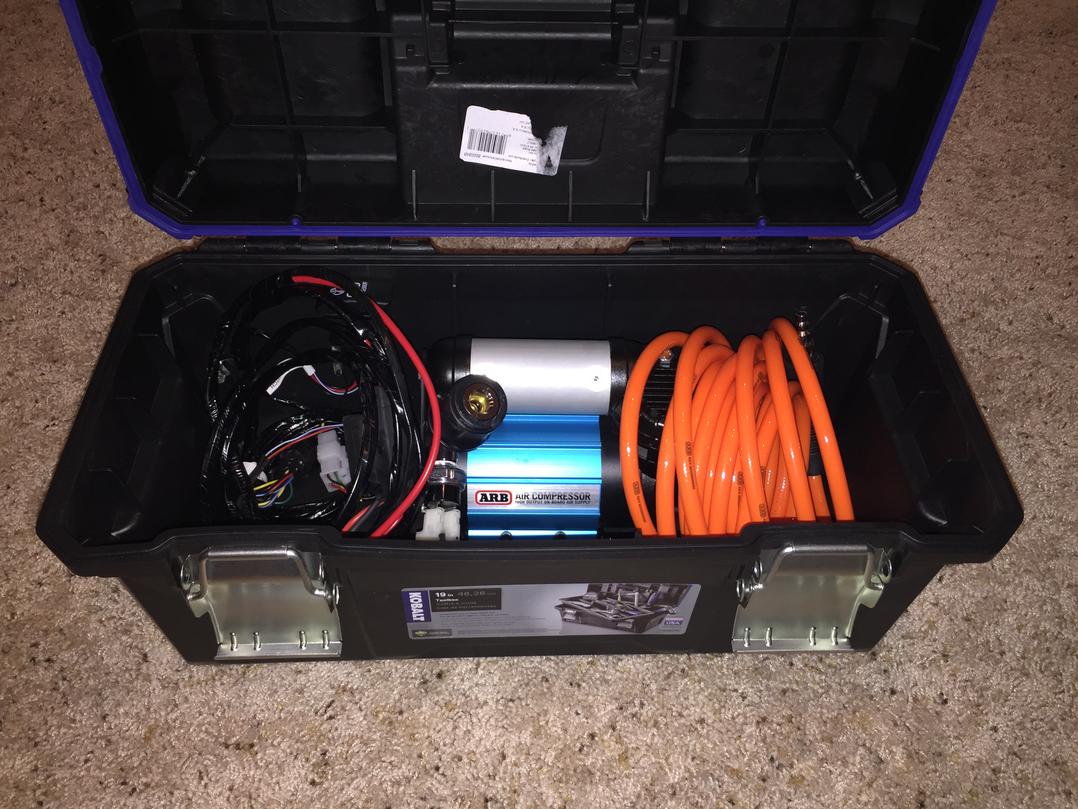

Mounted mine in a toolbox to make it portable. Bought a $15 Kobalt toolbox at Lowe's along with some mounting hardware. Kept the factory harness length as I may eventually install it in my truck. Taped off the air locker plugs and coiled the excess in the toolbox bottom on the compressor plug side. Works great!
