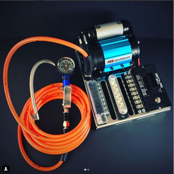

https://www.powertrays.com/collections/frontpage/products/5th-gen-4runner-powertray
Check out the powertrays mount for the arb single, switch pros, blue sea negative buss, blue sea fuse panel. This will house all my electrical distribution and compressor and leave other areas free for a second battery and DC/DC charger.
I got this and the quality is amazing. I picked up all the blue sea parts and am waiting till after the holidays to pick up the compressor and switch pros.

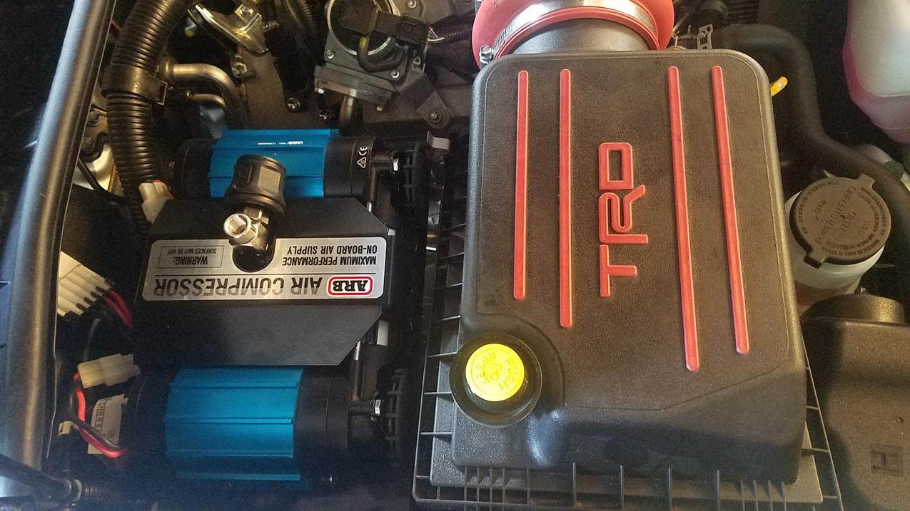

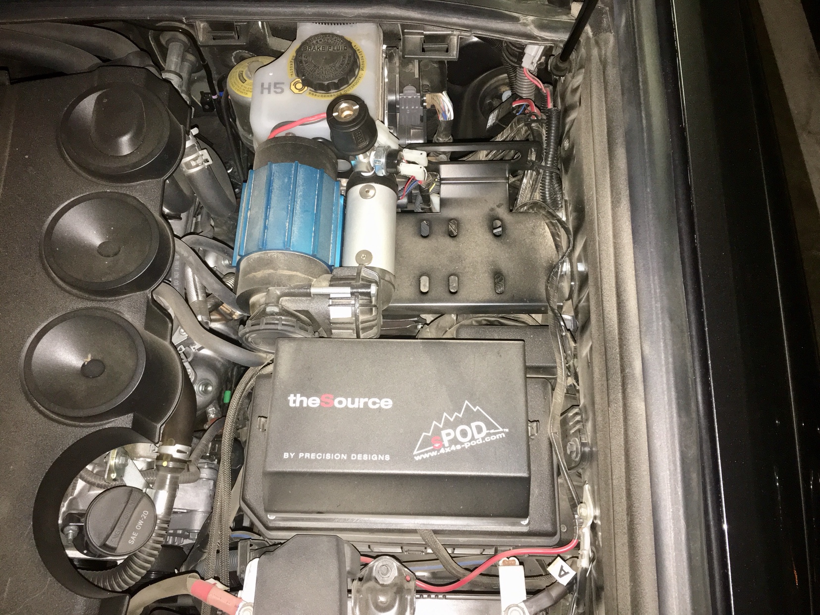

Here’s mine mounted with the Slee mount. Notice the sPOD. I just plug and play when adding new accessories.

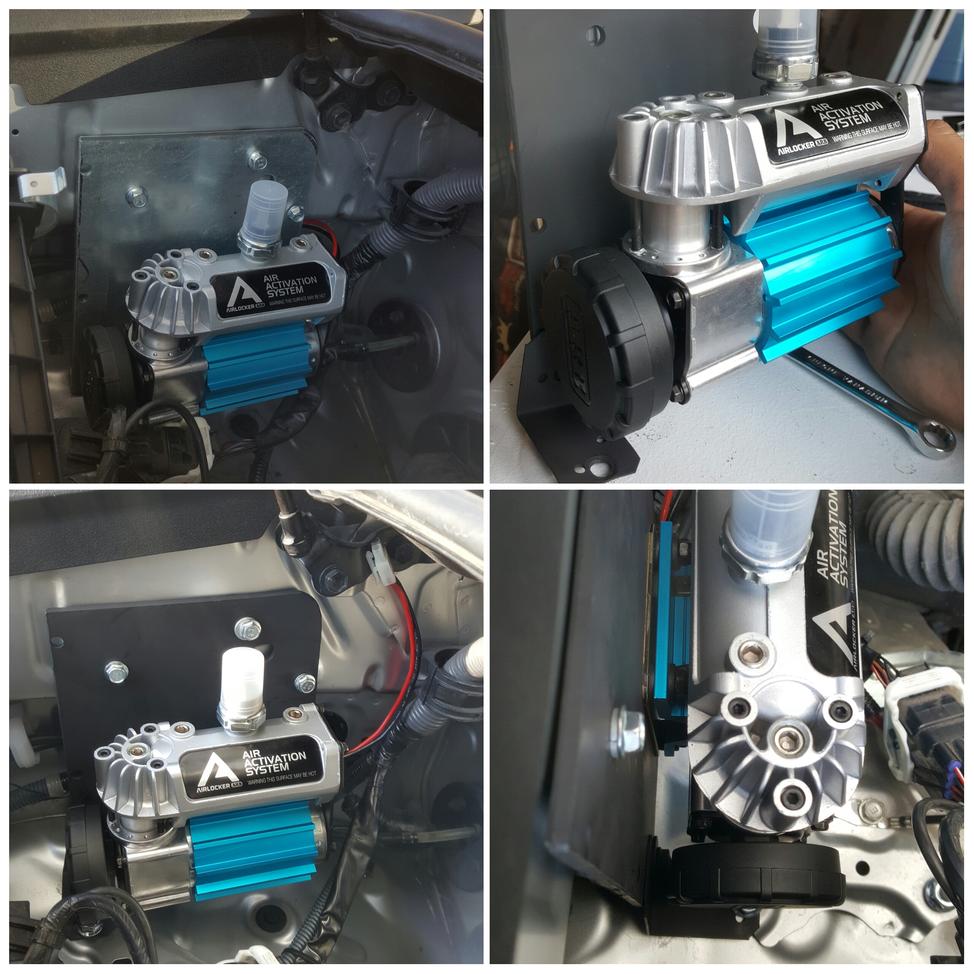

Has anyone used a 4*4 Labs mount?
This Guy
I saw it mentioned in another thread but I dont see pic of it being mounted.
The big reason I wanted to go with the 4*4Labs mount vs the SLEE is the 4*4Labs is that it mounts on the passenger side vs driver side. I want to keep the driver side open for the switch pro mount.
This Guy

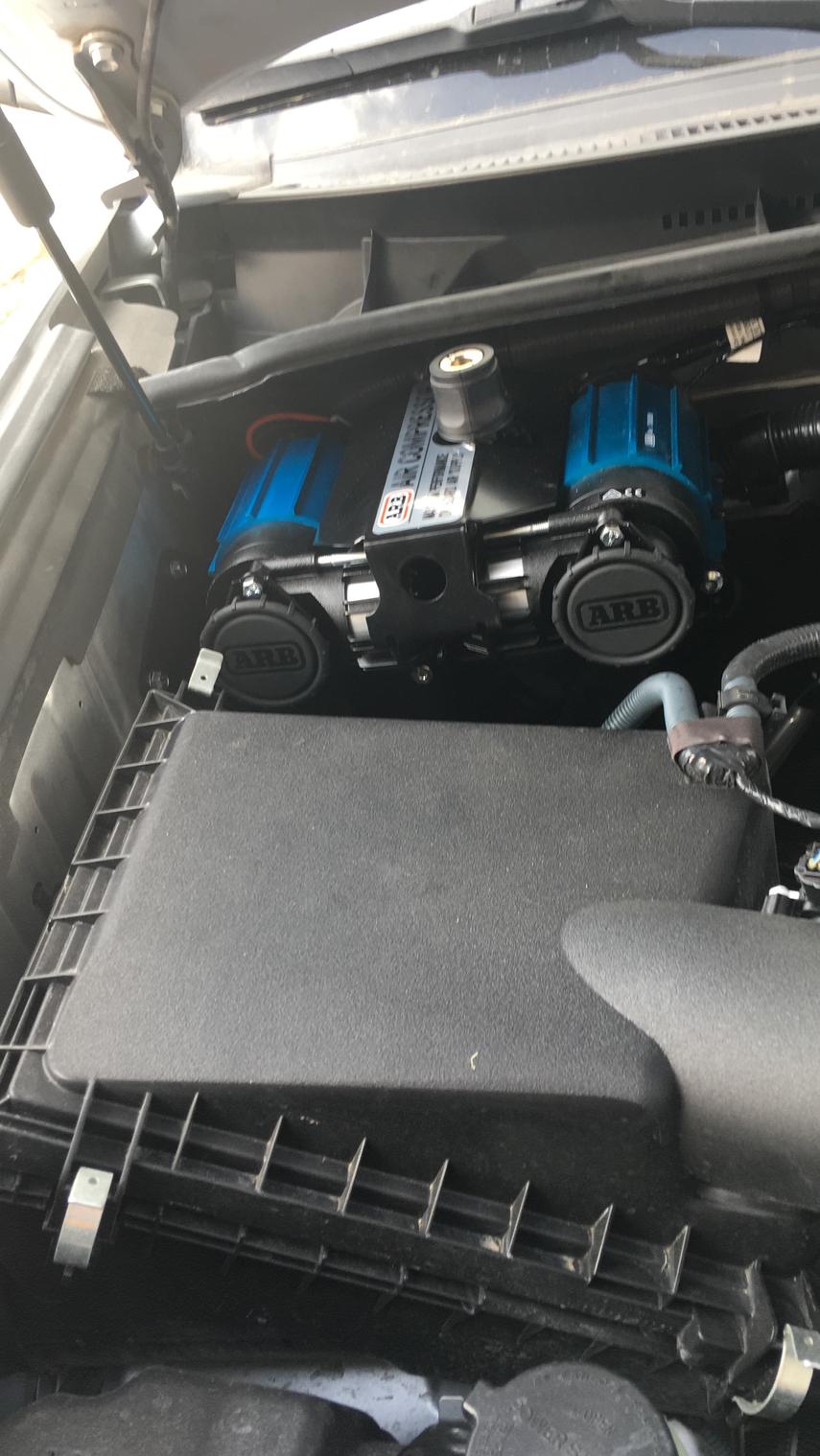

I've got mine in the passenger side hole in the engine compartment, along with a 1 liter cooling bottle to keep the hose from melting from the compression heat. The compressor is wired into my SwitchPro 9100 with a relay. I've heard of cases where, due to a second battery taking that space, folks have mounted the compressor between the radiator and the front grill, off to one side; though the ARB Twin is sealed, that sounds like a bit of a wet place to mount it.

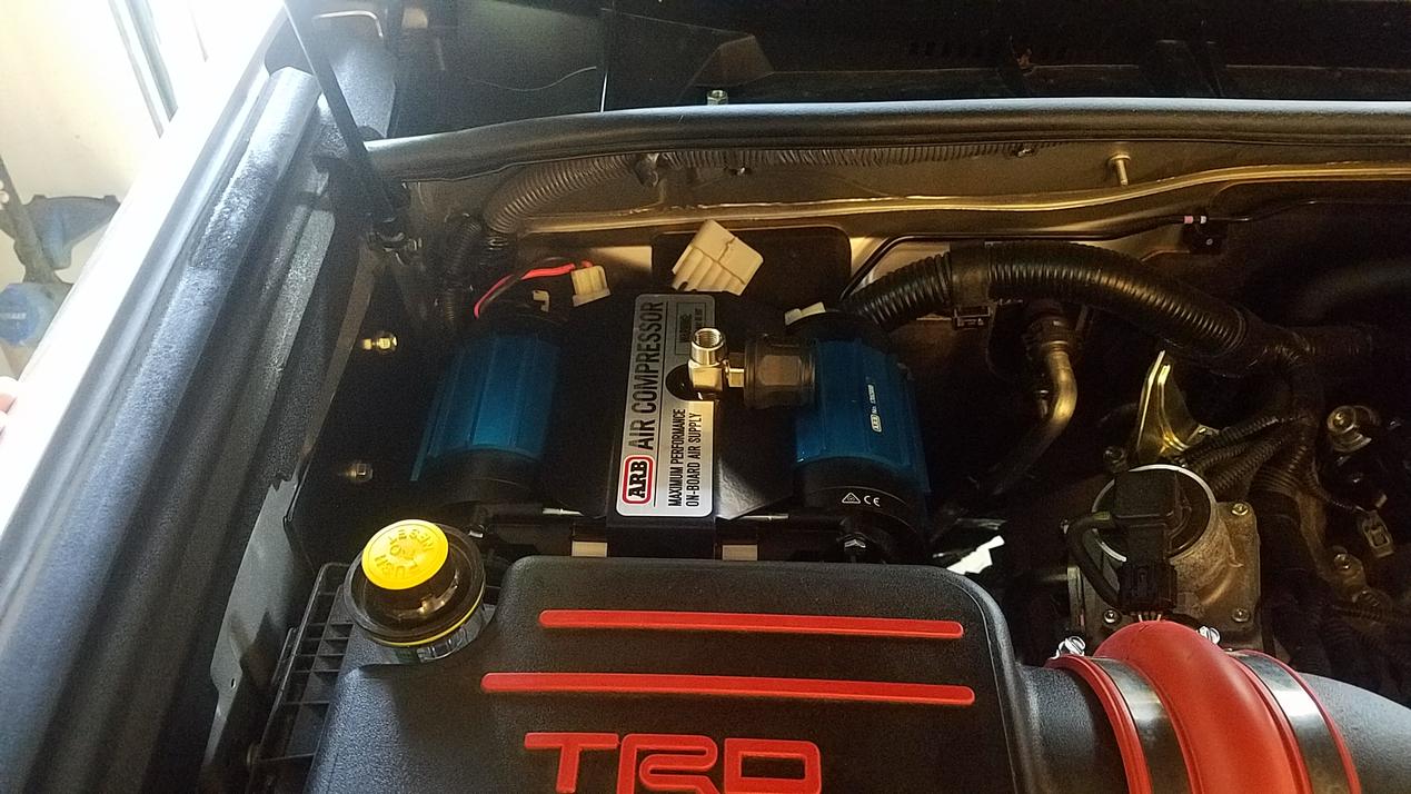

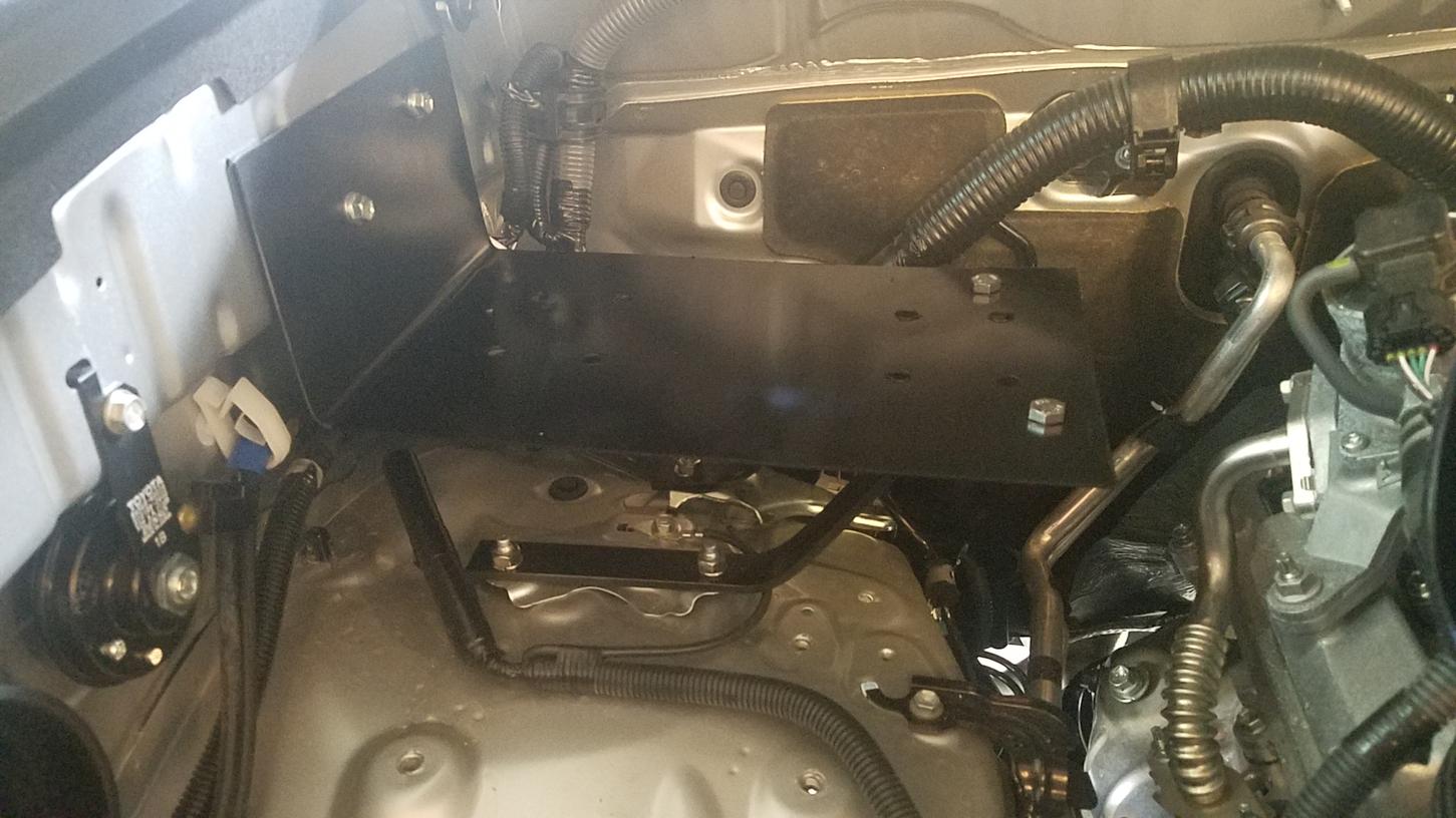

I just mounted mine on Friday. I fabbed up a simple mount with a few pieces of steel from the hardware store. I spent about $40 total. These are the only pictures I got of it.

just out of curiosity, are those m6 bolts to the fender?
