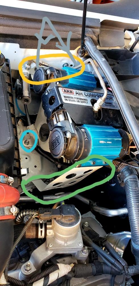

In the picture, the two attachment points circled in YELLOW, is where it tore the inner fender and in LIGHT BLUE was the 3rd attachment point. I added the bracket circled in GREEN, which has two additional mounting points at the bottom. The way it was set up originally seems to have created a lot of oscillating causing the issue is my conclusion.

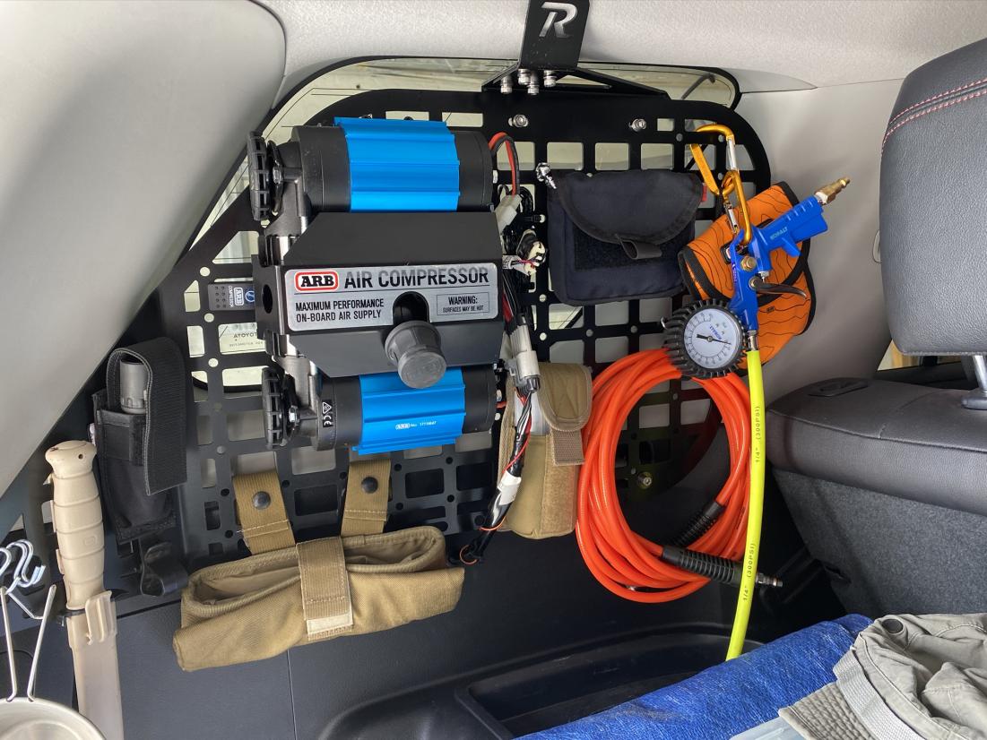

I previously had a single ARB mounted under the hood. Have since upgraded to a twin, and have it mounted to the Rago rack in the rear cargo area. Works great. Real happy with the twin and the location.

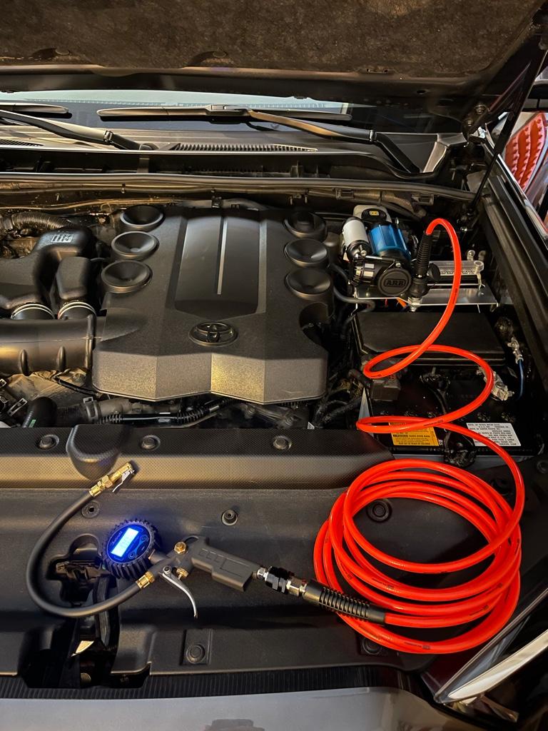

SDoffroadMT makes great mounts, have the outlet running back to a manifold with the coupler located just beside the hood strut

Mine in the rear cargo area isn’t bad. I have kids, they usually elect to stay in the car vs getting out. With the rear hatch open it’s not terrible. I might be wrong, but I’ve perceived the twin to be quieter than the single. I’ve only had the twin mounted in this spot. I much prefer it to under the hood. Cooler, cleaner.
In all, the noise isn’t as bad as one might expect. And it’s a couple minutes brief, anyway (fill all 4 tires simultaneously).
