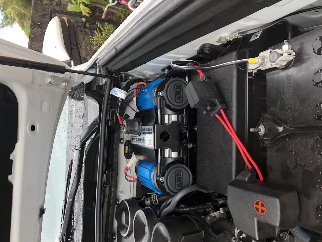

I got all the information I neede to mount my ARB twin compressor , Slee off road mount and ARB to AOB switch.

Got my pumps in yesterday, plumbing is done and now to tackle the wiring

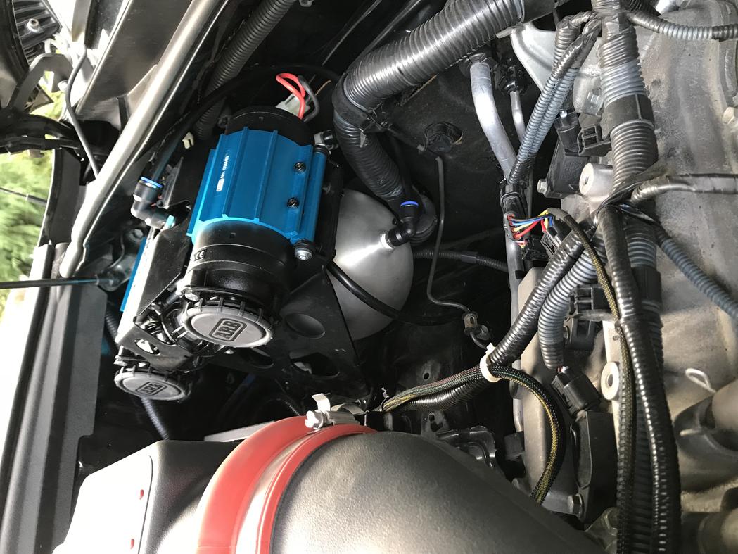

Bandi mount in conjunction with Shrockworks dual battery smog relocation
Hey thanks for the shot [MENTION=343163]SnoRnR[/MENTION].
See the picture I put right above your post ... there's a wire loom clip right where the Bandi mount appears to bold onto the side wall. What did you do there? Do you have to disturb the wire loom to do the install with the Bandi mount?

Im sure I just unclipped the loom and tucked it under the compressor mount. Plenty of room under the mount if you are not using a tank.

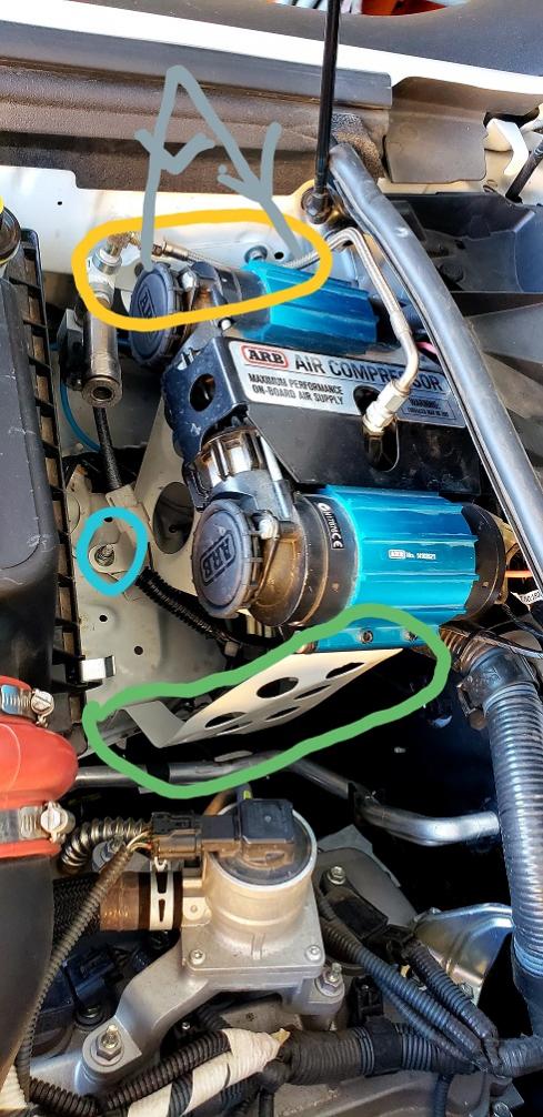

I would recommend against the 4x4Labs mount. With only 3 points of attachment, it ended up ripping the inside sheetmetal by the strut attachment causing an annoying rattle and an inside fender to fix. I ended up adding to the mount to add an additional 2 mounting points which greatly strengthen the bracket.

Where did you add attachments? Can you add a photo for us?

I did not replace, but had to do some welding, which is not fun on metal thinner than a beer can

In the picture, the two attachment points circled in YELLOW, is where it tore the inner fender and in LIGHT BLUE was the 3rd attachment point. I added the bracket circled in GREEN, which has two additional mounting points at the bottom. The way it was set up originally seems to have created a lot of oscillating causing the issue is my conclusion.
