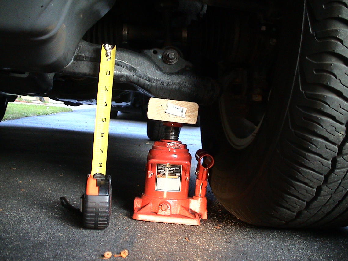

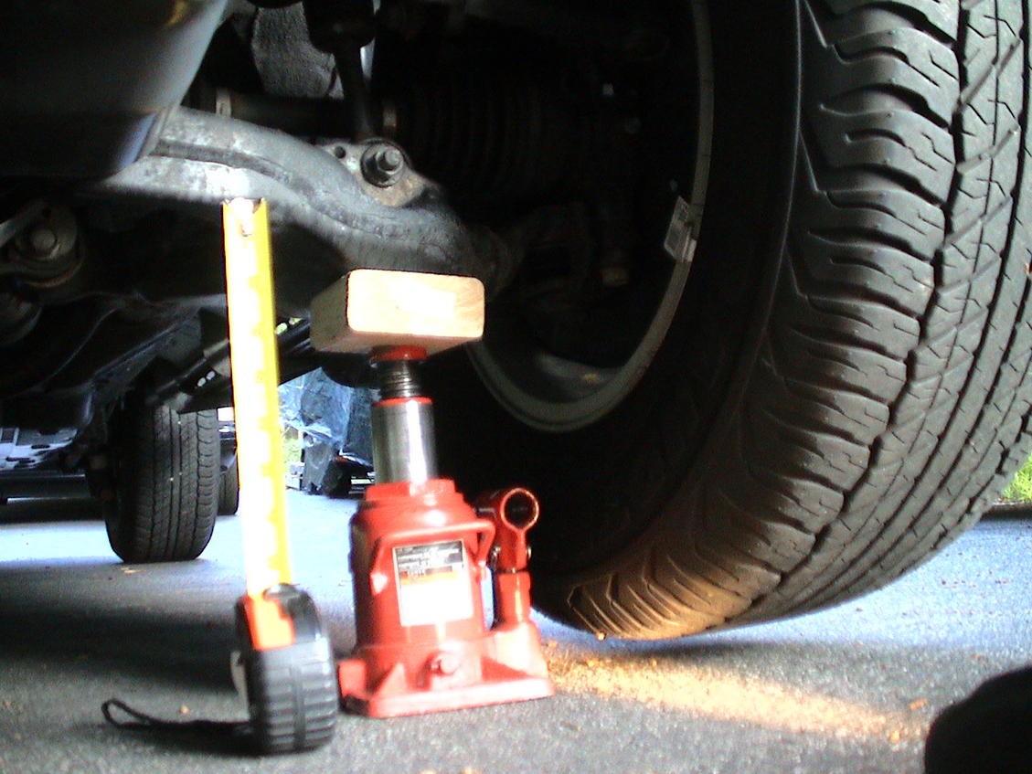

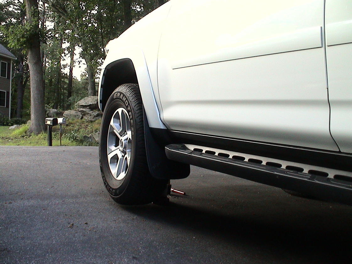

the Toyota jack is a POS.. the vehicle is very heavy and that jack and how it is fabricated IMO very dangerous ... my bottle jacks I use are solid good foot print and has the jack rod with the concave surface to hold the axle in place .
the stubby jack to lift the front wheel works great only a small amount to take tire off ground very safe.. Toyota manual procedure to jack up the front wheel is dangerous...
I did find a forum member mention this control arm lift and the jack he got .. harbor freight has these jacks try it out ..
post back how your results worked out ..

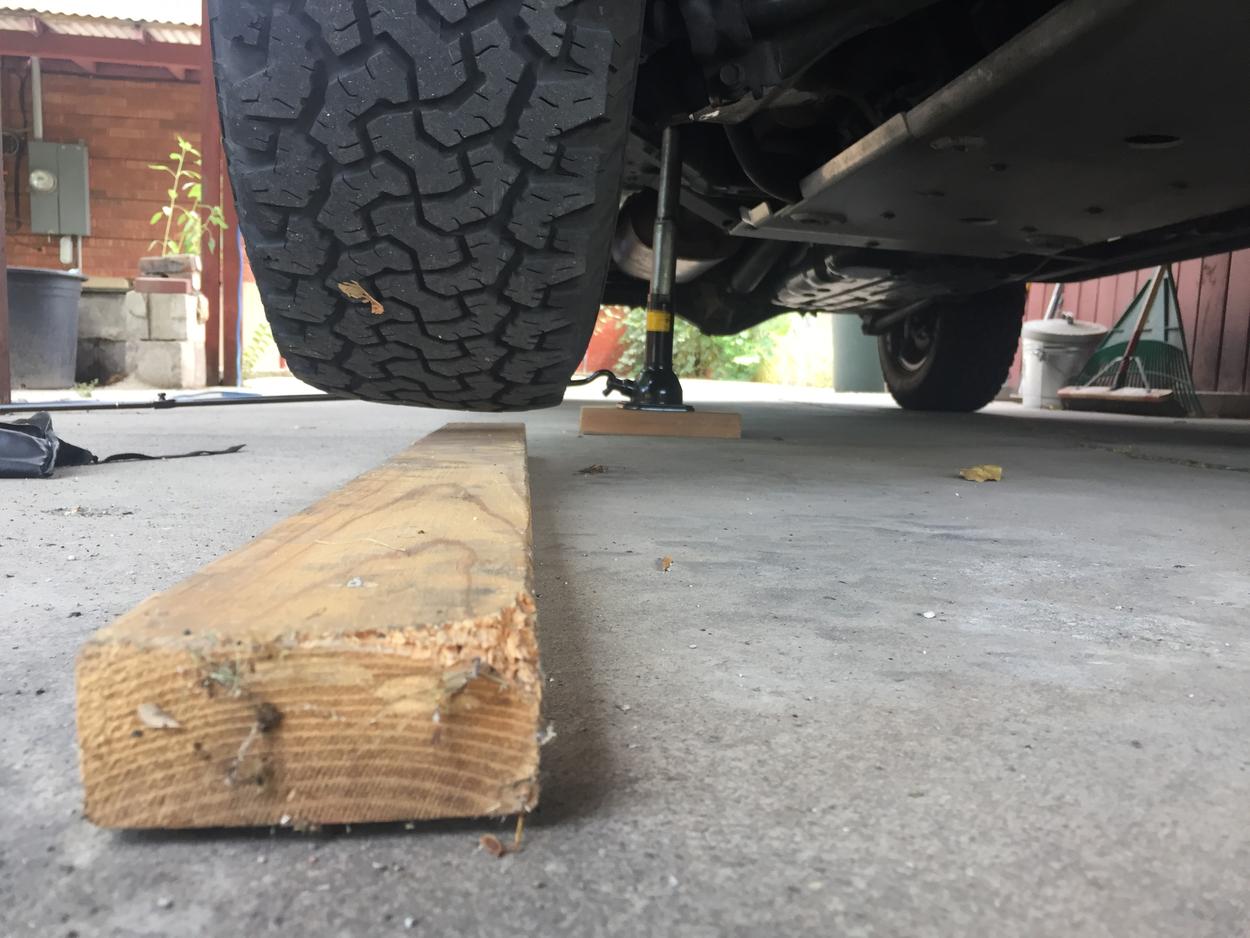

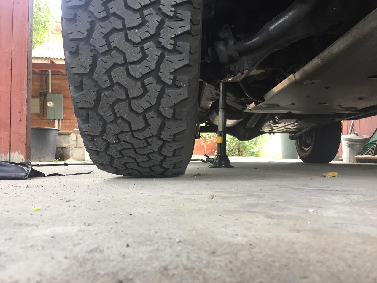

Just cause I am changing out my bump stops. Two pics, one with a 2x4 one without, both cases the wheel spins. 2x4 = wider more stable malleable base, regardless.
