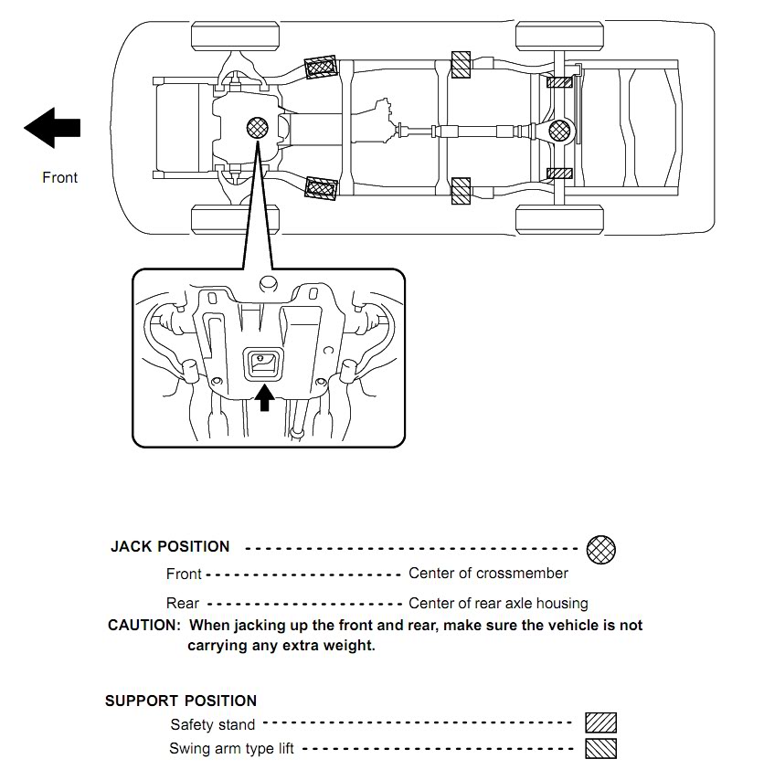

Where the heck are the jack points?? 2018 TRDORP w/ KDSS

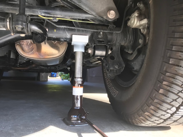

Factory Jack Used to Change Tire on level concrete
In my 2018 4Runner SR5, I had a flat...in my driveway...almost level concrete.
The OEM jack was OK removing the flat.
At first I couldn't get the spare on with the jack all the way up.
I matched up the wheel holes with the bolts and kicked it on from the bottom.
I needed another inch. I added a 2" thick X8x12 inch board for next time.
I also got a 6 ton bottle jack; I just tested it. It's fine doing the front wheel.
On the back axle, there's not much contact between the axle and the jack. I tried to knock the 4Runner off of the jack; it was OK. The bottle jack fits in the tool location; it's too big to fit where the OEM jack was. I just wrapped it in an old t-shirt and threw it in. I jammed in the other tools OK.
The manual is not that clear. The picture is too small. But thanks to the replies here I figured it out. Once I knew where to put the bottle jack, everything worked fine. Thanks

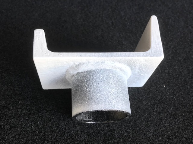

Electroboy,
That is a wonderful picture of where to put the jack on the rear and I really like the Adapter. Could you please take a similar picture of where to put the jack on the front? It would be much appreciated.
"of where to put the jack on the rear"

Electroboy,
I won’t be able to get a photo of the OEM jack in action on the front for a week or so. But the jack points are illustrated in the owners manual. And the first post of this thread shows the spots as circled. You’re actually on a flat spot on the frame. It’s a good stable spot but you’ll find that the jack gets extended really high to get a front wheel off the ground. Set the parking brake, block the other front wheel (2 blocks), and try jacking the front wheel.

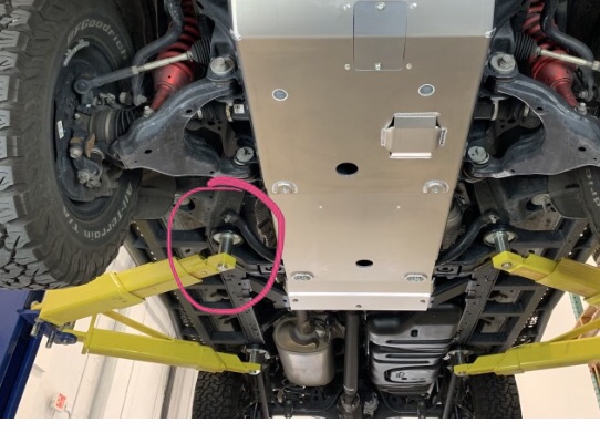

ElectroBoy,
I appreciate the information in your response and certainly have looked at the diagram in the owners manual and the one on the thread. My truck has had RCI skid plates installed in the past and therefore finding the part of the frame to put the jack is not clear to me. If you have time to take a clear picture next week of a spot that would work for that setup, I would like to see it. Would using the control arms work?

No, do not jack up at the control arms. Jack the frame per previous descriptions and the manual. I have stock skids, but what I’ve seen of photos of RCI skids, you still have frame access near the cross member. Unless your skids are different. Maybe post a photo of your setup in that area so others can verify.

ElectroBoy,
Thank you, thank you, thank you. I now, finally know where to put the jack. Seems simple, now that you have shown me exactly where it goes.

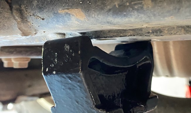

I've jacked up the front of the truck only. This is a 6 ton jack stand, Big Red bought off Amazon. I placed the jack over under hole in the frame shown in the top of this thread.
I'm concerned with the way that the jack stand makes contact with the frame at only one point on the near side furthest from the camera. The frame on the side of the weld nearest the camera is higher so there will never be contact on both sides of the weld. With the angle of the lift it only makes contact at one point. Is this safe?
Also, when lifting from the recommended single point at the front of the truck on the rock plate the truck lifts unevenly with the driver side an inch or so lower. Is this normal or is my garage sloped?
My orientation looked the same using my “Daytona” 6 ton Jack stands from the People’s Republic OF China aka Harbor Freight.
I switched to the Hein-Werner jack stands and now the frame is still resting one one point but that point is in between the flanges. I feel slightly safer.
