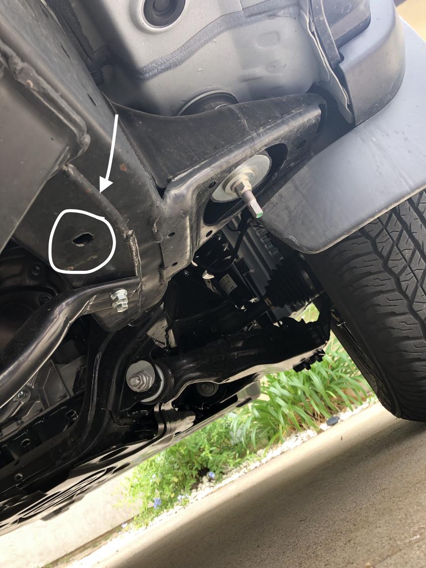

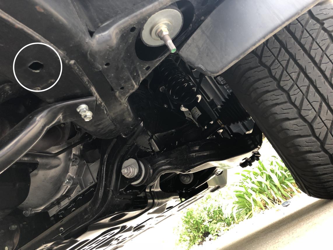

For the front wheels, from the diagram in the owner's manual, it looks like maybe I should jack from near where I've circled in the photos???? But I'm lost for back wheels...

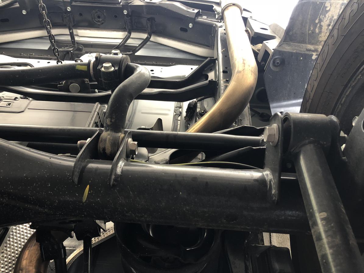

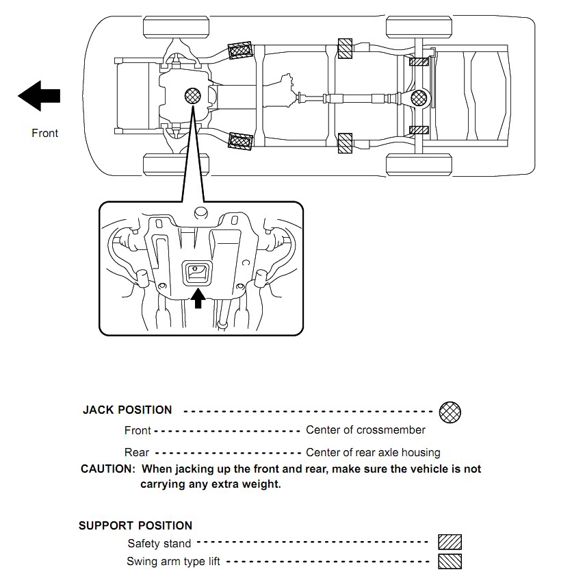

so here are the jack points
now what I also did was purchase a stubby jack so I can jack up under the front lower control arms works great very little lift to remove tire ..
when I rotate my tires I place the 3ton floor jack under the pumpkin [rear diff] and use the stubby to lift one side of the front tire works great little lift very stable .. jacks up 3 inches ..
Pretty much anywhere on the frame side rails is good to go, ou just want to be close to the wheel you are working on for stability. You can lift both rear tires from the rear differential but might want to save that for a floor jack.

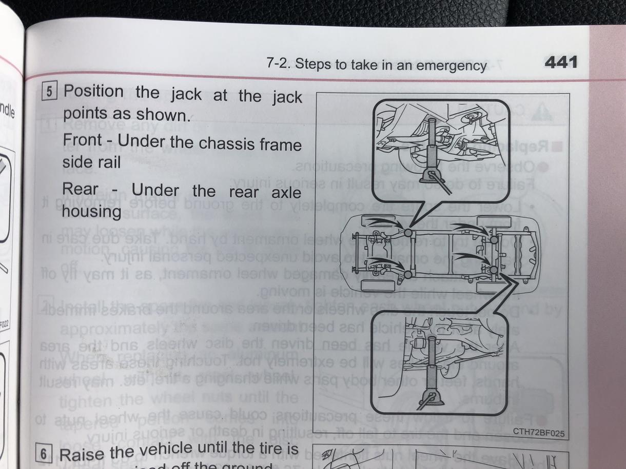

This is what my owner's manual has... which for my level of knowledge & comfort is not sufficient... (because I don't want to (a) break the damn thing, or (b) break myself when it falls off the jack!)

How is that not sufficient? Not trying to be rude, but they tell you exactly where to place the jack? With words and a drawing.

New to this vehicle and this type of vehicle. Rear axle housing is round. The top of the supplied jack is flat. Call me silly, but I’d prefer not to kill myself or destroy the vehicle when I’ve got it jacked up improperly and it falls off.
It’s not like I asked without having looked at the manual or without having crawled under the vehicle. Is it so wrong to ask??

No it’s fine to ask. I’m not trying to be a dick or know it all. But trust the manual. IIRC the top of the jack has some texture. Once you get the weight of the vehicle on it a bit it won’t move.
I was out running errands and stopped by a local Toyota dealer service shop & talked with the service foreman. Nice guy. He climbed under there with me and showed me both where he would put his larger jacks (if not on a lift) as well as where Toyota recommends that I put the provided jack.
For the rear jack points, it is in fact on the rounded axle cover. He said not to worry about it coming off the jack so long as the parking brake is on... and to line up the small amount of (he called it cupping, but it's really more of a small groove) on the jack head with the axle cover.
