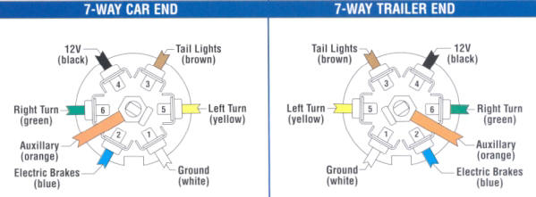

If you
Found this on a different thread. Looks like the wiring harness does have the wiring for a brake controller.
