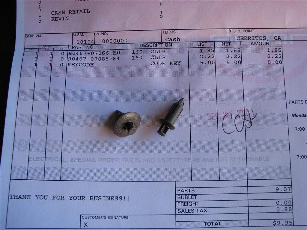

The clips that secure the interior door panel to the door. Not the clips on the INSIDE of the door panel, but the ones with the push center. There is a small one on the end of the door panel and another one that is larger right under the tweeter. Mine on both sides are broke. :(
I would be surprised if you couldn't get them from Toyota. If you cant, find a junkyard with a 3rd gen 4runner, Usually you can find those kind of things EXTREMELY easily. :thumb3:
I just got two of these from my local dealer. I think they set me back just over one American dollar a piece.
Great thanks for the info guys! Does anyone know what they are technically called? I need to call the dealer to make sure they have them before I drive out there.
This was for a 96 with tan interior.

The part numbers (-E0, -E4) listed in this thread are for the beige clips, does anybody know the number for the grey ones?
Thanks.
