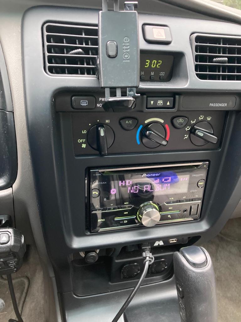

I have an AnyTone AT-779UV in mine, but you need access to it. I took out the ashtray and fit it in there.

Pic of the Anytone in the ashtray location:

I used zip ties so that I could return to stock without damage. Zip ties are not visible, good n snug.
Did you build a bracket for this or just wedge it in the ashtray space?
I mounted my Anytone in the same spot.
I trimmed the ashtray opening with a Dremel and used the bracket that came with the radio, bolting that to the console bezel in a similar spot to where the ashtray screws to.
