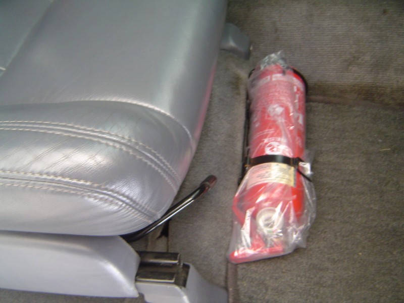

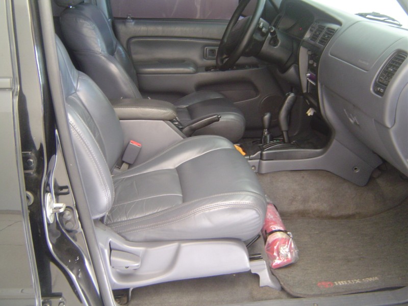

This is where I've got mine....

It's a Kidde, rated 10 B:C. That covers flammable liquids (ie gasoline, oil), and energized electrical equipment. The only other rating you may want to consider is D, which covers flammable metals, but since we don't have a whole lot of Magnesium on our engines, I wouldn't worry about that one.
Also, don't get an A:B:C class extinguisher. The agent they use in A class extinguishers actually melts at about 300 degrees, and if sprayed on an engine, it will be very difficult if not impossible to remove because it will melt and bond to the surfaces of your engine. Plus there's not alot of trash, wood, or leaves in your engine bay.
The only reason I could see for considering an A class extinguisher would be if you wanted it to put out an out of control campfire or something.
Finally, you don't have to get an "AUTO" fire extingisher. You'll pay more because it's an "AUTO" and they are usually rated 5 B:C, just look for a 10 B:C and you'll be fine w/that. The numerical rating is a measure of how large a fire the extinguisher can put out, and only applies to the "B" rating.

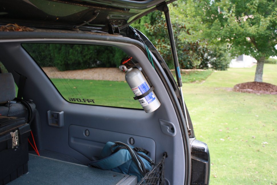

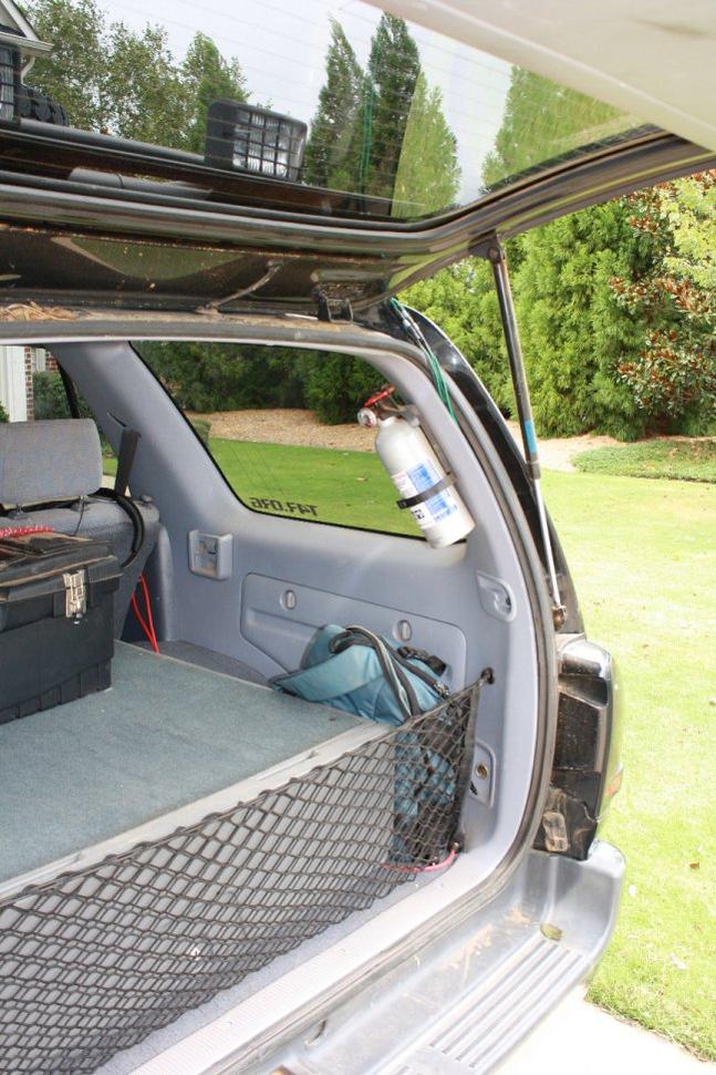

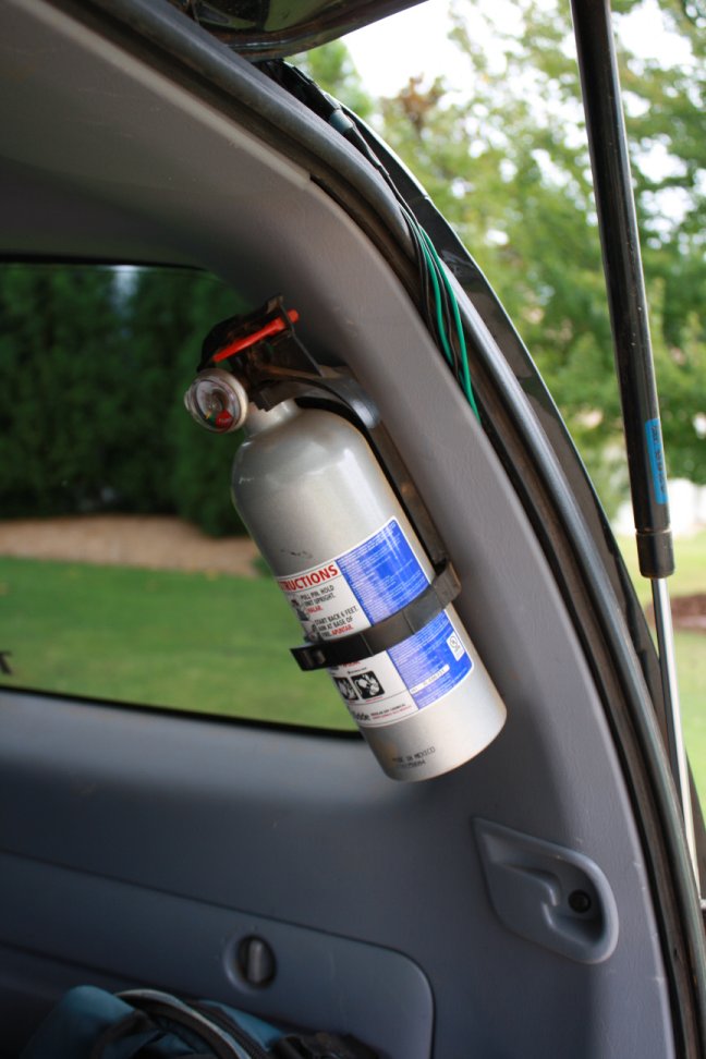

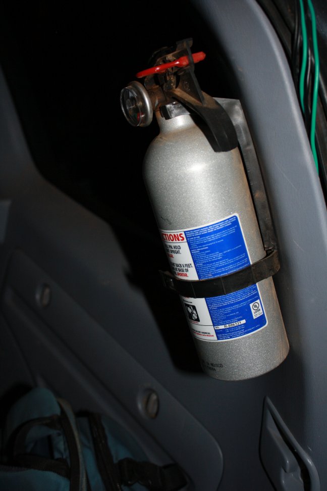

I've got mine in the rear cargo area, attached to the passenger side pillar. I popped the trim out, drilled some holes and voila! I almost always wheel with my back window down, so then I can just reach in and grab it. It's up and out of the way, and very secure.
I'd like to see more pics of the rear storage you got there, please.
