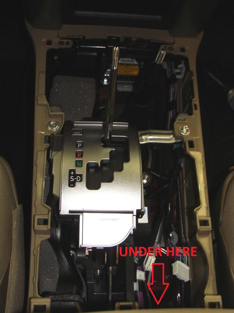

You can mount the box in the center console under the armrest(after pulling the shifter trim)- under the area where the 110v outlet is. I wrapped mine in some adhesive foam weatherstripping to keep it from rattling around, and strap-tied it to a plastic bracket under there. Gotta figure, if you ever change your antenna, or need to adjust the SWR for any reason, you will need to get to that box to hook up the meter. Simple as cutting the strap-tie and replacing it.
EDIT- Here's a pic (from sp8ball's collection) to clarify...
FWIW - I did basically the same thing as Antman. I left the box wedged under something-or-other down there after my install because I didn't tune my antenna directly after install. So, when I went back to tune the antenna and noticed it hadn't moved. After I tuned the antenna I put it right back where I found it - didn't screw it in to anything.
