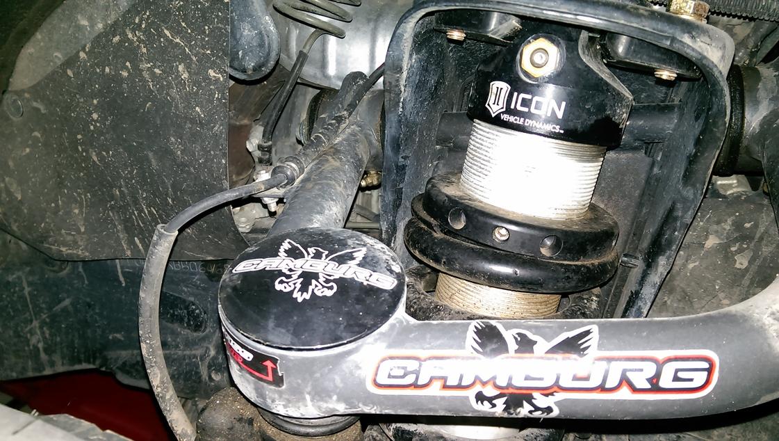

Hey [MENTION=106176]wfo9[/MENTION] I just installed a set of the camburg moog ball joint UCA's. Wondering if you can post a picture of your clamp for the speed sensor wire? Just wanted to compare. Thx.
Will this do [MENTION=91899]Jhalko[/MENTION]
[MENTION=106176]wfo9[/MENTION] or anyone, everything is together but can't get the castle nuts torqued properly, what might I be doing wrong? It almost looks a bit misaligned but not sure the best way to straighten it out.
If I understand what you are asking correctly. You can compress the suspension with a floor jack to get things to align better.
Best jack point for that? That would make sense as it's just a little off.
LCA under coil over connection.... I use a 4x4 wood block usually, but anything will work.
Just be careful not to push it off the jack stands.
Another option is to remove the coil over. It can go back in with the UCA on.
That made a huge difference and was able to torque it down, Camburg says 80ft lbs. can't get my torque wrench in just the regular ratchet. Should be fine to drive to the tire store I would assume, I can have them check the torque?
Thanks for the pic and advice [MENTION=106176]wfo9[/MENTION] got her all buttoned up and a short drive. No lights, it'll be straight to the tire store for tires and alignment next!
Good lessons learned and the satisfaction that I didn't pay someone to do it for me...
