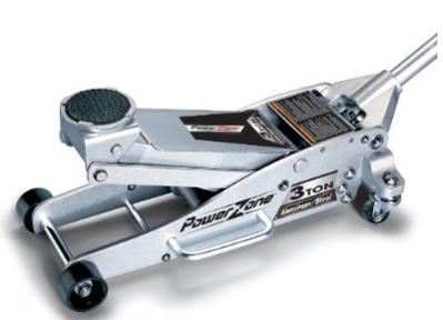

I have this one. It's worked out great so far, it's portable and even saved my ass in death valley.
$149 | Powerzone 380044 3 Ton Aluminum and Steel Garage Jack
https://www.amazon.com/gp/product/B003UM7B98/
Goes up to 18.25". I used to bring my HiLift with me on trips. Now I bring this.
