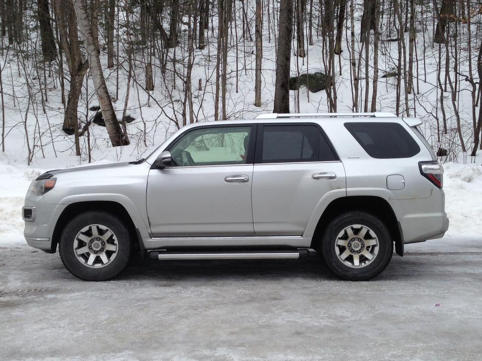

I also have set of Trail rims dedicated to winter tires for my 2014 Limited. I am very happy with the Nokian Hakka R2 SUV. They have been great both in the city (slush, slick roads) and out in cottage country (snow, hard-packed icy roads etc.).
