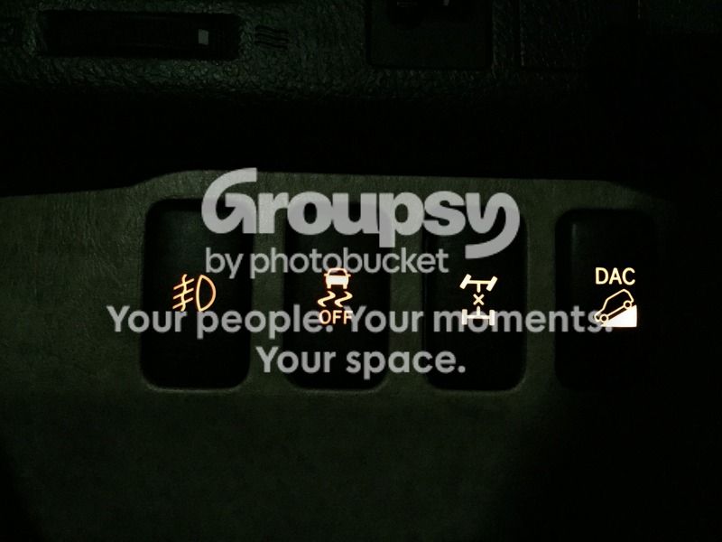

So, I've been rolling around with my VSC wires unplugged from the master cylinder for some time now (vsc sucks!!!!) and read about the mod where you can add in a switch to make it more formal yada yada yada
So I bought the switch # 84988-35070....
I understand how to interrupt the circuit by splicing in a wire but how do I connect my interrupting wires to the back of the switch? there are 4 pins to connect too
Thanks for the help,
Alex

I already modified the switch to stay on constant, I'm just not sure about the 4 pins... I'm assuming 2 are for a power/ground for the light bulb and the other 2 are the accessory (Hack) slots in this case I just am not sure which pins should be hooked up to what
I'm sorry, I interpreted that wrong- I thought you were looking for which wires to hack into in the 4x4 computer.... My bad
Look at the LED in the switch, you can trace the pins (Pos & Neg) from it. That's just the switch light. Of the 2 remaining pins, one goes to ground and the other taps into the wire from the 4x4 computer.
I have a similar switch and I started the mod myself, but haven't spliced the wire yet. Switch light works with other buttons though...looks perfect...
